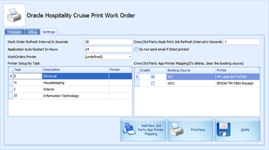

Configuring Printer for Work Orders
  1. Log in to the Administration module and select System Setup, Database Parameters.
  2. At the Maintenance Parameter group, set the value to one at:
    1. Use Work Order Printer Service.
    2. Print by Task (print the work order by task).
  3. Click OK to save and exit the application.
  4. Launch the Print Manager application and navigate to the Settings tab.
  5. Set the Interval Seconds and Auto Restart In Hours for the module.
  6. At the Task Type, select the printer from the list for each task type.
  7. Click Apply to save.
Configuring Printer for Third-Party Application
By enabling the following parameters, third-party application print jobs are spooled and trigger an email alert once a print job is received. The parameters also update the records in Shore Excursion and Ticket modules. This application works with the printer defined in the Management module.
  1. Log in to Print Manager program.
  2. At the Settings tab, set the print job refresh interval seconds.
  3. To disable the email notification once a ticket is printed, select the Do not send email if ticket printed checkbox.
  4. Click the Add New 3rd Party App Printer Mapping button to enable a printer.
  5. Select a printer for each type of booking source from the drop-down list.
  6. Click Apply to save.
  7. Restart the interface.

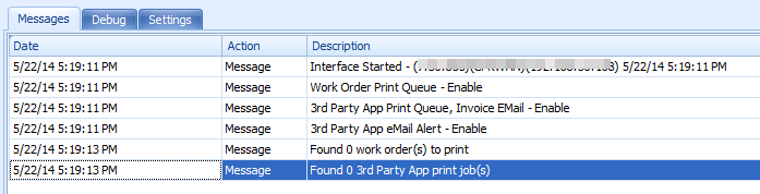

  8. If the printer is set up successfully, the action task appears in the Messages tab.
Figure 15-2 Print Manager - Messages Tab
This figure shows the Print Manager Messages Tab
The values of the above settings are stored in OHCSettings.par

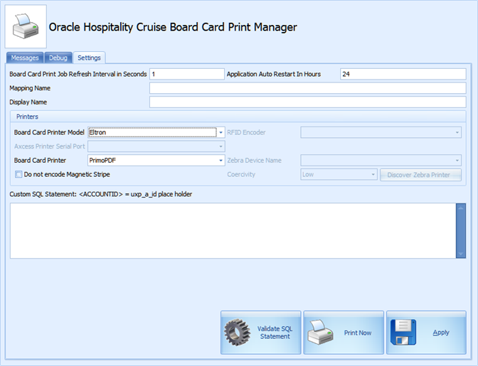

Configuring Printer for Board Card Printing
To print a board card, the OHC BoardCard Print Manager is used. This application works with Board Card printers only. It runs in the background and processes print job requests received during check-in.
In the Settings tab of the application, the default HeartBeat Internal value is set at 60 seconds. You can change this to meet your operational needs.
  1. Log in to the OHC Board Card Print Manager application.
  2. At the Settings tab, enter the Mapping Name and Display Name for the printer.
  3. Set the print job refresh interval seconds.
  4. Select the Board Card Printer Model and Board Card Printer from the drop-down list.
  5. In the SQL statement section, leave the setting blank to print all card types.
  8. If the printer is set up successfully, the number of active task appears in the Messages tab.
Figure 15-3 Print Manager Settings for Board Card Printing
This figure shows the Print Manager Settings for Board Card Printing
The values of the settings entered are stored in OHCSettings.par
