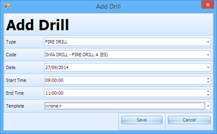

Figure 18-2 Add Drill Window
Table 18-1 Add Drill Field Description
Field Name Description Type
Displays the drill definition without courses and certificates assigned. Refers to Drill Type setup.
Code
Displays all definitions linked to Drill Definition setup of the selected drill type.
Date
Planned drill date.
Start Time
The drill scheduled start time
End Time
The drill scheduled end time
Template
Proposed eligible crew to the scheduled drill based on Safety Department, Safety Position, Safety Group and Safety Function assigned in the Drill template, and all templates setup in Drill Template are shown.
At the Add Drill window, select the Type, Code, Date, Start/End Time, and Template from the drop-down list.
Click the Save button to save the drill. Dates that have scheduled drills are shown in red on the calendar.
