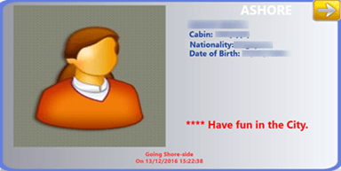

When passengers/crew pass through the Security Gate to go ashore or board the ship, they are required to either swipe, scan, or tap their board card on the devices made available at the security gate. Once the board card is swiped, the account status changes from onboard to ashore or vice versa.
Alternatively, you can manually change the status using the account search. The Security Officers typically perform this process for passengers who lost their board card while on shore.

When disembarking crew swipe their board card through the MSR. The system prompts an Ashore Denied Override dialog box with the following message: ‘The person is ashore denied; do you want to override the onboard status?’. Click Yes to change the account status to Ashore and display a “Crew Disembark Today” statement on the Ashore Status Information board.

The system prompts an alert on the WPF Security window at the point when the passenger swipes, scans, or tabs their board card on the card reader devices, allowing the Security Officer to read out the message to the passenger. Click Yes at the message sets the message as Acknowledged in the system.
