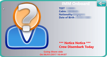

Immigration Gate Handling
The Immigration Gate Handling is used in some countries to facilitate the Immigration clearance at checkpoints according to Immigration Rules.
Setting up Immigration Gate
Figure 19-11 Immigration Onboard Status
This figure shows the passenger/crew status when they passes through the Immigration Gate.
When the WPF program is launched, the Security Officer must determine the location of the checkpoint, gate type and the traffic direction. See section Accessing WPF Security for gate type.
The passenger and crew are required to either swipe, scan, or tab their board card on the card reader when passing through this gate, with IMM Onboard or Ashore indicated on the Account Information board.

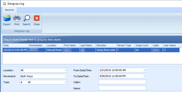

Gangway Log
The system records all movements through the Security Gate by date, workstation, location, name, movement direction, account type, cabin number, and user name. These entries can be exported to a text file, report, or Microsoft Excel sheet.
Figure 19-12 Gangway Log
This figure shows the Gangway Log function which enable you to retrieve movement logs.
Table 19-4 Gangway Log Search Option
Search Criteria Description
Location
Gangway location setup in Administration, Gangway Locations.
Movement
List of direction of the movement.
Type
Account Type:
A – All.
P – Passenger.
C – Crew.
V – Visitor.
From Date
Start date of the search.
To Date/Time
End date of the search.
Cabin
Cabin Number.
Name
Name of the person you want to search.
  1. At the WPF Security Toolbar, click the Gangway Log. This prompts for a re-login.
  2. At the Gangway Log window, select the type of information to export/print using the drop-down list.
  3. Click Search at the ribbon bar to populate the information onto the grid.
  4. You can sort information shown on the grid by the header name, by clicking the column name, or right-clicking the header to bring up the customizable sort option.
  5. Click Print to print the report or click Export to export the report template to another format.
  6. Click Close to exit the Gangway Log window and return to the WPF Security main window.
