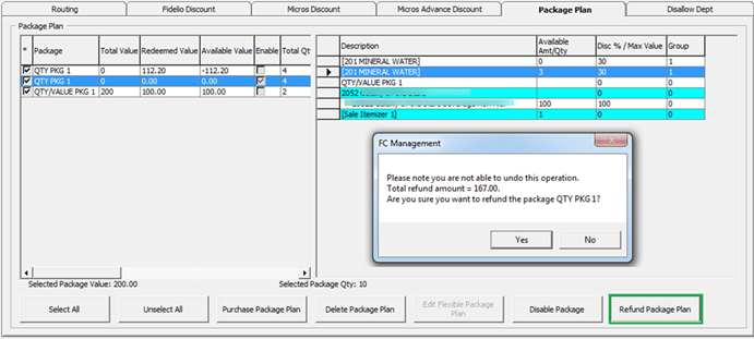

  1. In the Disc, Route, Pkg tab of the crew account, select the Package Plan tab.
  2. Select Refund Package Plan.
    Figure 7-51 Package Plan Refund Option
    This figure shows the Package Plan Refund Option
    WARNING:
    Once a Refund is processed, it is not possible to reverse the changes. This process also disables the package plan.
  3. Once the package plan is refunded, the system disables the package and displays the remaining value/quantity for reference only.
  4. If the postings are more than the package price, the system prompts that a refund is not allowed.
