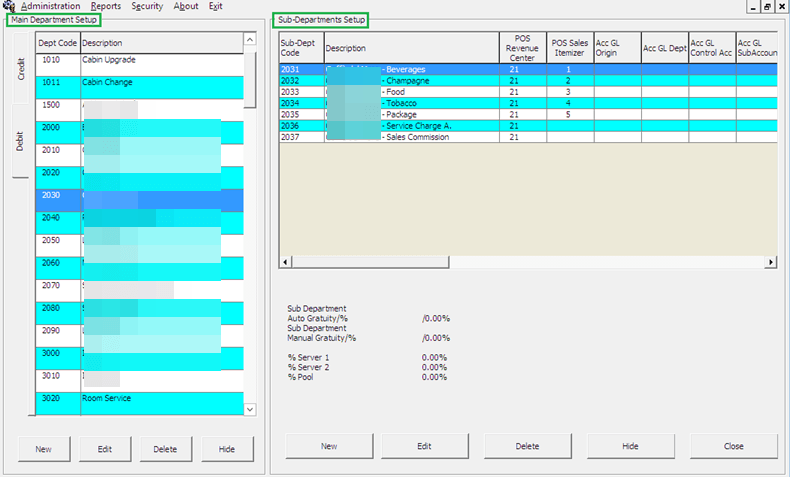

The Department Codes is where all debit and credit posting codes are stored, and codes entered are mapped to the Back Office Accounting System using the General Ledger (GL) ID. These codes are sub-divided into several codes within a Main Group.
Figure 9-12 Main/Sub-Department Setup
This figure shows the configuration window for Main Department and Sub-Department codes.
Main Department
The Main Department code is the higher level of grouping of the approved Chart of Account and in this instance, the revenue or cost centers. The Main Department Setup is comprised of two tabs: a Debit and Credit tab. In general, the Debit departments are the revenue centers and outlets, while the Credit department represents the payment methods accepted by the Ship. All codes are entered through Administration, Financial Setup, Department Codes.
Adding a Main Department Code
  1. From the Administration, Financial Setup menu, select the Department Codes option.
  2. Select either a debit or a credit tab.
  3. Click the New button located at the bottom of the screen.
  4. Enter the code, description, and other required fields approved by your Financial Department and then click OK to save.

Sub-Department
You can only add a Sub-Department when the the Main Department code is present. The information required in a debit sub-department code defers from the credit sub-department code, although the process to create them is similar.

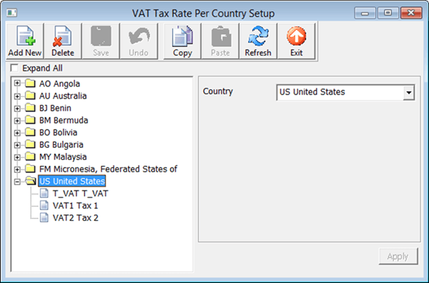

VAT Tax Rate
The VAT Tax Rate code is used to define the various tax rates applicable to each country or class, and the tax posting code.
Figure 9-13 VAT Tax Rate Per Country Setup
This figure shows the configuration screen for the VAT Tax Rate.
  1. From the Financial Setup menu, select VAT Tax Rate.
  2. Click Add New at the ribbon bar and then select the Country code from the drop-down list.
  3. Click Save.
  4. Expand the Country container and select the Tax Class.
  5. Insert the tax rate in the VAT Tax Rate field and select the Tax Department code from the drop-down list.
  6. Click Save to save the changes.

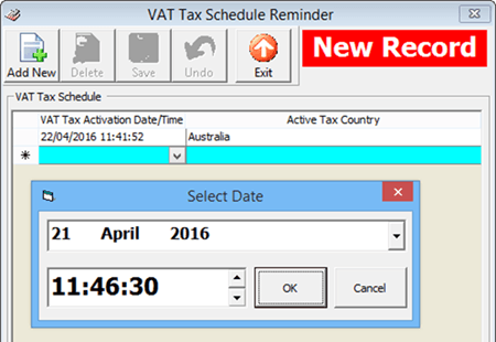

VAT Tax Reminder
A reminder can be added to remind you when to activate the tax country on a specified date.
Figure 9-14 VAT Tax Reminder
This figure shows the reminder scheduler for the VAT Tax
  1. From the Financial Setup menu, select VAT Tax Reminder.
  2. Click Add New at the ribbon bar, and then select the Date and Time from the drop-down list.
  3. From Active Tax Country, select the Country in which the tax is to be activated.
  4. Click Save to save and exit.
