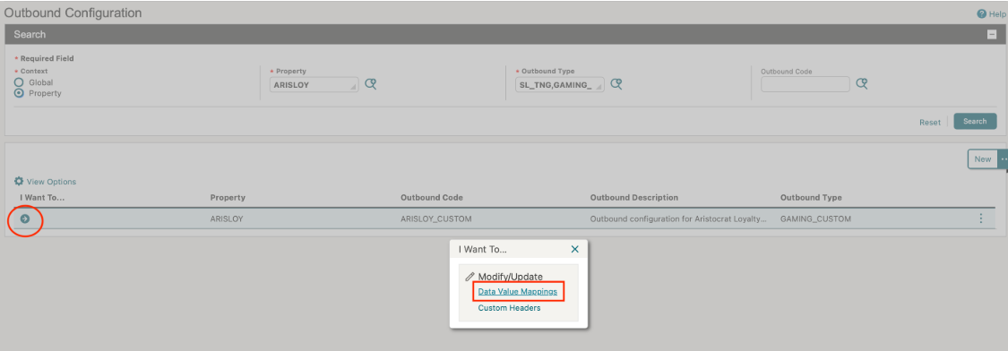

Configure the DVMs for this outbound configuration. Click the I Want To... and select Data Value Mapping.
This image shows how to select Data value mappings.
