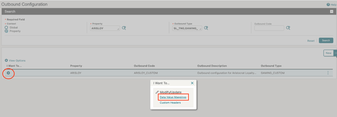

The following Data Value Mappings (DVMs) must be set up for the Aristocrat Loyalty system. DVM configurations are required to convert the categorical values from OPERA Cloud to Loyalty (and vice-versa). For details on how to create DVMs within OPERA Cloud, see Data Value Mappings in the OPERA Cloud Services documentation.
The below DVM values are for reference only and can vary by property.
