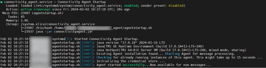

To check the status of execution for the connectivity_agent.service, execute the below command. Make sure the status is active (running), and the last msg log is "Agent started successfully... Now available for new messages..."
sudo systemctl status connectivity_agent.service

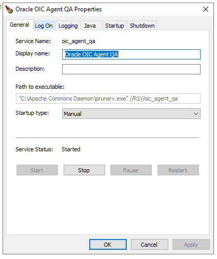

You will also find it on the system tray with this
icon. There you can manage the service (that is, start, stop, and configure the service).

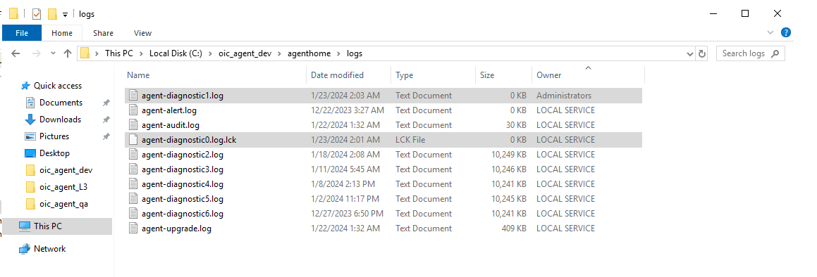

Open Microsoft Windows File Explorer on the folder %AGENT_ROOT%\agenthome\logs.
Delete all files that end in .lck and that are not owned by LOCAL SERVICE. For example, see the files in the below image:
