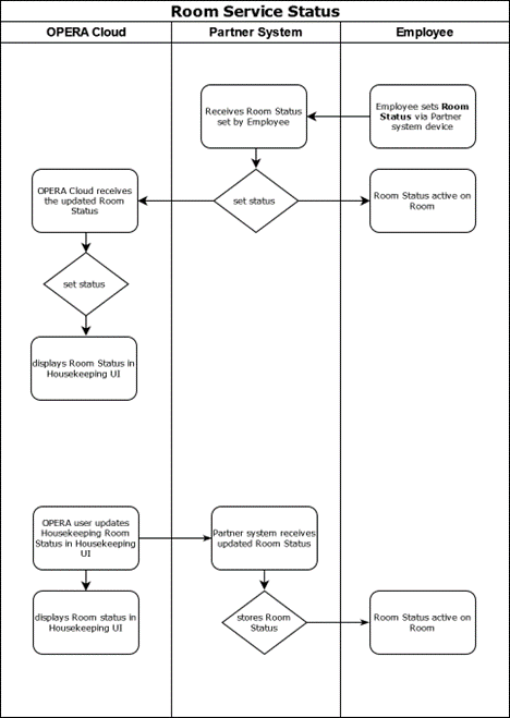

Table 1-1 Workflow Diagram
This image shows the Room Service Status workflow.
Employee sets the Room Status in the Partner system.
The hotel employee can set a Housekeeping Room Status using the partner application or device.
Once the employee sets the related Room Status, the partner system handling the device or software sends a setRoomRelatedStatus API call to OPERA Cloud with the related Room Status, for example, "Clean," "Dirty," or "Inspected."
OPERA Cloud receives the message from the partner system and sets the received status in its system and displays it in the OPERA Cloud Housekeeping Room status section.
With the setRoomRelatedStatus API, the employee can also set a PickUp required or PickUp completed status as well as a Turndown status request.
