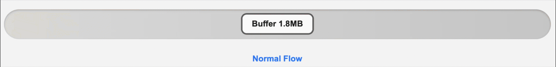

When large amounts of events are produced by OPERA Cloud, the streaming API begins sending events in bursts (backpressure mode), moving onto the next burst dynamically based on the line speed. OHIP determines the latency by sending a ping to the consuming client and measuring the latency between that and the pong response sent by the client (see the image below). The pause interval is now determined dynamically based on the line speed.
The below animation illustrates this.
The backpressure mode flow.
