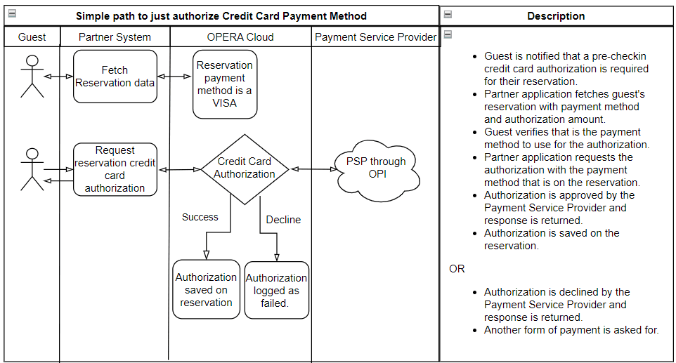

Figure 1-1 Scenario 1: Credit Card Authorization with Reservation's Existing Credit Card Payment Method

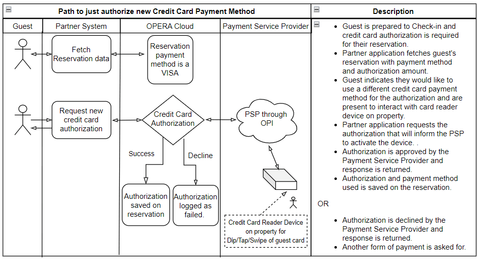

Figure 1-2 Scenario 2: Credit Card Authorization with a New Credit Card Payment Method Captured on Credit Card Reader Device

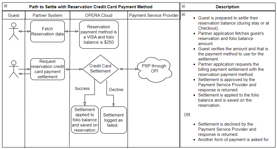

Figure 1-3 Scenario 3: Credit Card Settlement with Reservation's Existing Credit Card Payment Method

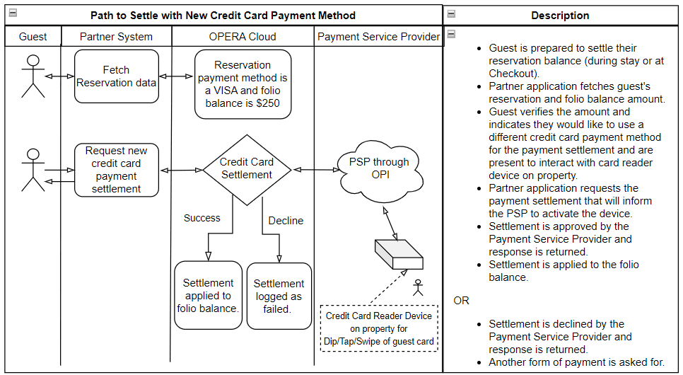

Figure 1-4 Scenario 4: Credit Card Settlement with a New Credit Card Payment Method Captured on Credit Card Reader Device
