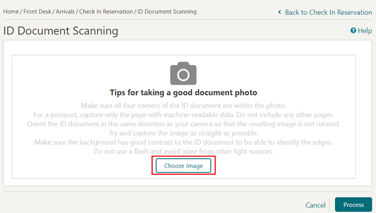

Click the Scan ID Document button in the Identification panel.
In the ID Document Scanning screen, click the Choose Image button to display the device camera options.
Select Choose Image (Note: this can vary based on used device). Follow the listed tips for taking a good document photo when capturing the image.
The captured image appears in the ID Document Scanning screen. Review the image to confirm it meets the good document photo criteria.
To retake the image, click Choose Image again. The new captured image replaces the existing image in the screen.

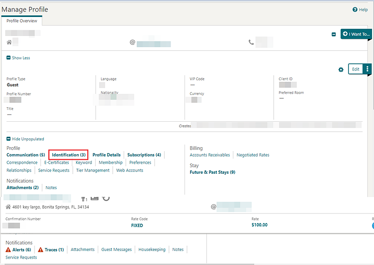

From the OPERA Cloud menu, select Client Relations, select Profiles, and the select Manage Profile.
Search for the desired Guest or Contact type profile and click the Profile name hyperlink
In the Profile details section, click the Identifications hyperlink or panel.

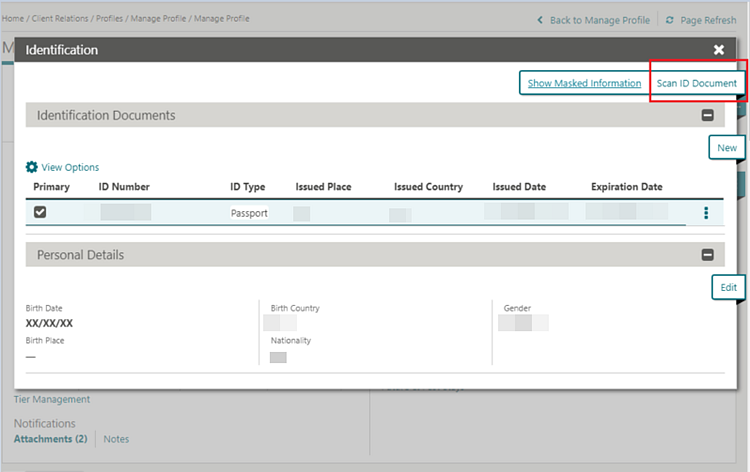

Click Scan ID Document in the Identification panel or popup.
