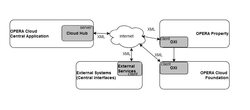

OPERA Cloud Hub is an integration component for the OPERA Cloud
Central solution. OPERA Cloud Hub integration enables asynchronous OXI (XML) communication
between OPERA Cloud Central Services and (remote) OPERA Cloud Foundation or OPERA Property
properties using OXI integration or other External Systems type Central Interfaces (OXIHUB).
There can be only one Central Interface configured per Property connecting to an external
system. External system must act as client to push and pull messages from Cloud
Hub.

OPERA Property OXI Communication Methods
Cloud Hub always acts as Server. The Cloud Hub Event Manager URL must be obtained from Oracle services team during provisioning and configure OXI communication mode as client with the Event Manager URL, along with the chain-level integration user created in Manage Interface User, with Interface Type = Cloud Hub and then activated.
