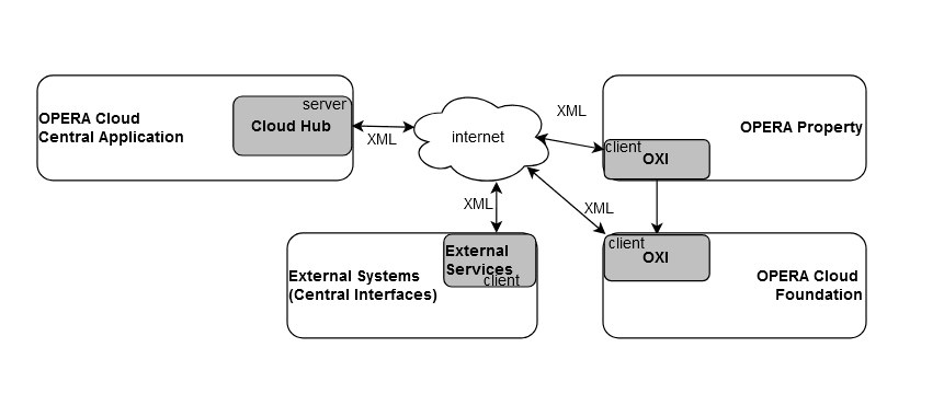

Central badge. OPERA Cloud Hub is an integration component for the OPERA Cloud Central solution. OPERA Cloud Hub integration enables asynchronous OXI (XML) communication between OPERA Cloud Central Services and (remote) OPERA Cloud Foundation or OPERA Property properties using OXI integration or other External Systems type Central Interfaces (OXIHUB). There can be only one Central Interface configured per Property connecting to an external system. External system must act as client to push and pull messages from Cloud Hub.

OPERA PMS or any external system (central interface) which supports OXI specification can connect with Cloud Hub as a Client and Push and Pull the XML messages from Cloud Hub Event Queue.

Cloud Hub always acts as Server. The Cloud Hub Event Manager URL must be obtained from Oracle services team during provisioning and configure OXI communication mode as client with the Event Manager URL, along with the chain-level integration user created in Manage Interface User, with Interface Type = Cloud Hub and then activated.
