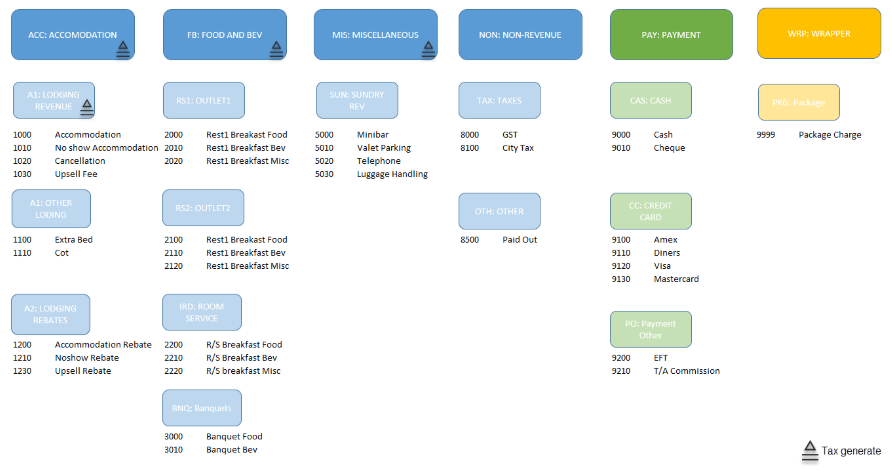

Figure 14-5 Transaction Codes
Transaction code number can be a 20 digit value, by default it displays 10 digits, you can expand the column width to see the full transaction code. You can use Reporting and Analytics (R&A) for reports. For example, all room related charges could be in the 1000 group; food and beverage related charges in the 2000 group, and so on. You should always allow for future growth as your requirements change by leaving openings in the transaction code sequence.
