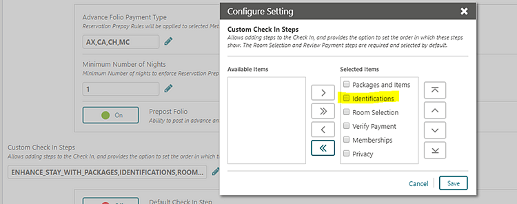

The Identifications panel must be selected for the Custom Check In Step OPERA Control. For more information, see OPERA Controls — Front Desk-
