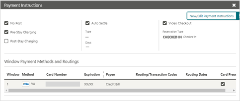

Click I Want To… and select Payment Instructions.
Click New/Edit Payment Instructions.

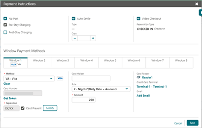

Click the payment Method drop-down and select the payment type of your choice.
Enter the Credit Card Number.
Enter the Expiration date in MMYY format.
The new Token is received and the authorization on the previous card is released.
Click Save.
