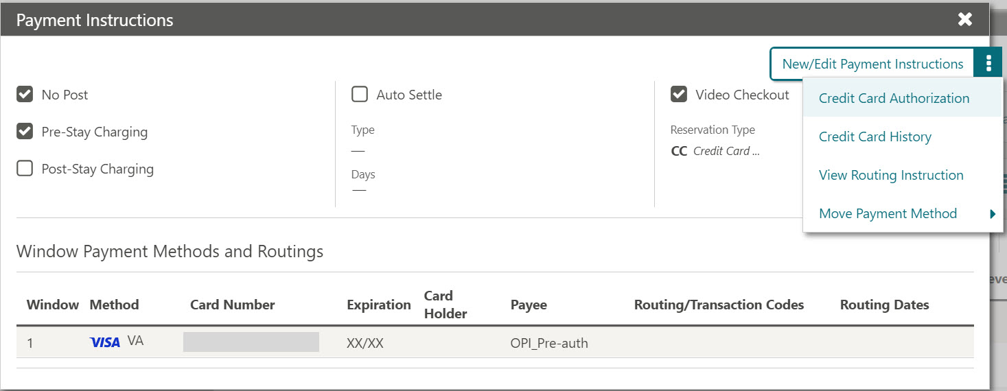

From the OPERA Cloud menu, select Bookings, select Reservations, and then click Manage Reservation.
Search for and open the reservation.
Click I Want To… and select Payment Instructions.
Click the vertical ellipsis, and select Credit Card Authorization.

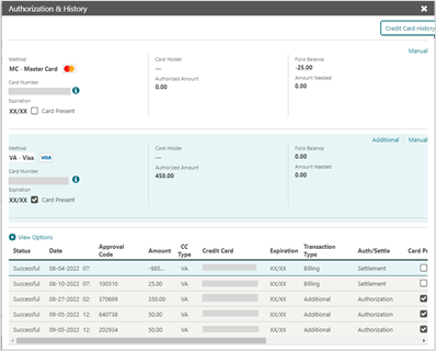

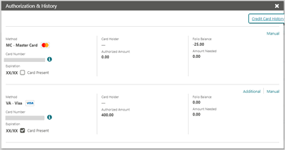

The Authorization and History screen appears.

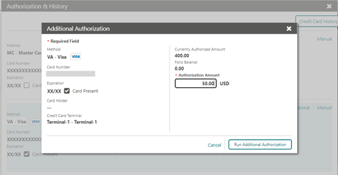

Click Additional option to obtain additional authorization amount on the required payment method or window.
Enter an Authorization Amount.

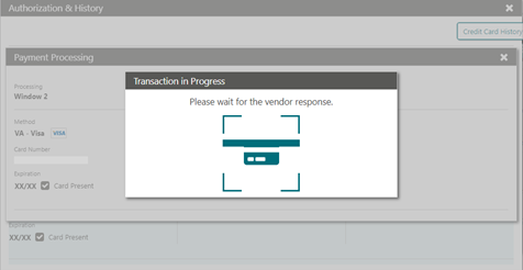

Click Run Additional Authorization.
The payment processing screen appears.
Confirmation of posted authorization appears in theAuthorization and History screen.
