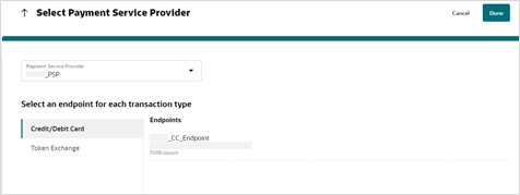

  6. Click Select to select the Payment Service Provider.
    The Select Payment Service Provider screen appears.
    This image shows selecting the Payment Service Provider

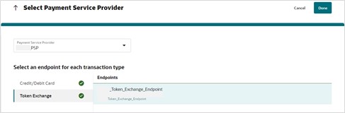

  7. Select the Payment Service Provider from the list.
    Once the PSP is selected, the lists of configured endpoints for each transaction type are displayed.
  8. Select an endpoint for each transaction type (Credit/Debit Card or Token Exchange) from the Endpoints list.
    You can use the up arrow Up arrow icon icon to navigate to Tenant Core Configuration screen.
    This image shows selecting an endpoint for Credit Card or Token exchange transaction type
    Once the endpoints are selected for each transaction type, you will see a tick mark next to the Transaction Type (Credit/Debit Card or Token Exchange).

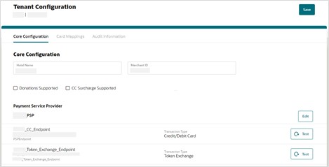

    The Tenant Core Configuration screen appears with mapped PSP endpoints.
    This image shows Tenant Core Configuration screen appears with mapped PSP endpoints.
  10. Click the Test Test icon icon to test the endpoint connectivity.
    • If the PSP endpoint test is successful, the connection is successful.
    • If the PSP endpoint test is unsuccessful, the connection fails.
      If a test fails, you need to access the OPI Cloud logs to review the issue.
    This image shows PSP endpoint test connectivity
  11. Click Save and you will see a confirmation that Core Configuration has been updated successfully.
