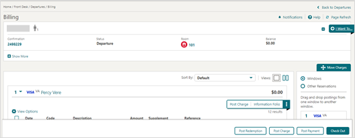

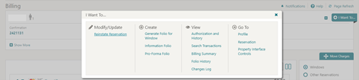

  3. Select the checked out reservation in the search result, then click I Want To. . . and select Go To > Billing.

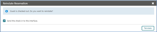

  4. Click Reinstate Reservation.
    This image shows how to reinstate reservation

  6. Click Reinstate.
    This image shows how to select the check in to the interface
  7. Select Post Charge if you need to post a new charge or skip this step if the charge already exists.
    This image shows how to post a new charge

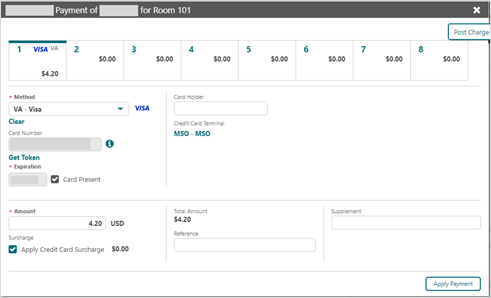

  8. Click Post Payment.
  9. The tokenised card on file will pop-up as the Payment type with the final due amount.
    This image shows tokenised card on file as the payment type with the final due amount
  10. If a new card is provided for the additional charges, then manually enter the Card Number and Expiry dates. See Credit Card Guarantee through the OPERA Cloud Application (Manual Entry– OPERA Pay) section for details.

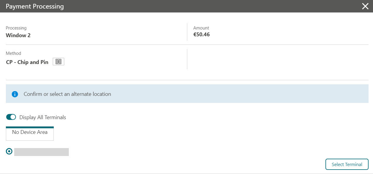

  11. Click Apply Payment to activate the Payment device.
    If you are accessing the Payment device for the first time after Chip and Pin installation, a panel appears to select a Payment Terminal (the pin pad terminal mapping is previously completed by the OPI Installer).
  12. Select a terminal to be activated for this transaction.
    Once the terminal is selected, it will be saved for future use until the application or browser cache is cleared. The payment device will alert the customer to present the card. After guest inserts / swipes a card, if transaction is successful, a Token, Card Type, Expiration, and last 4 digits of the card number is returned to OPERA.
    This image shows selection of a terminal
