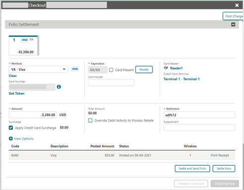

The Folio Settlement confirmation screen appears.
Verify the card information on file:
If replacing the main card with a new card, update the payment method, verify the amount, and click Settle and Send Folio. This step triggers the Payment device.
If using the same card on file, proceed with the below steps.
Verify theAmount to be settled and click Settle and Send Folio.

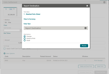

Select the Destination option for the folio, and then click Process to view the report.

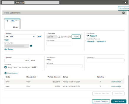

Click Check Out Now.
The guest is checked out successfully. To review the guest’s reservation information, click Go to Reservation.
