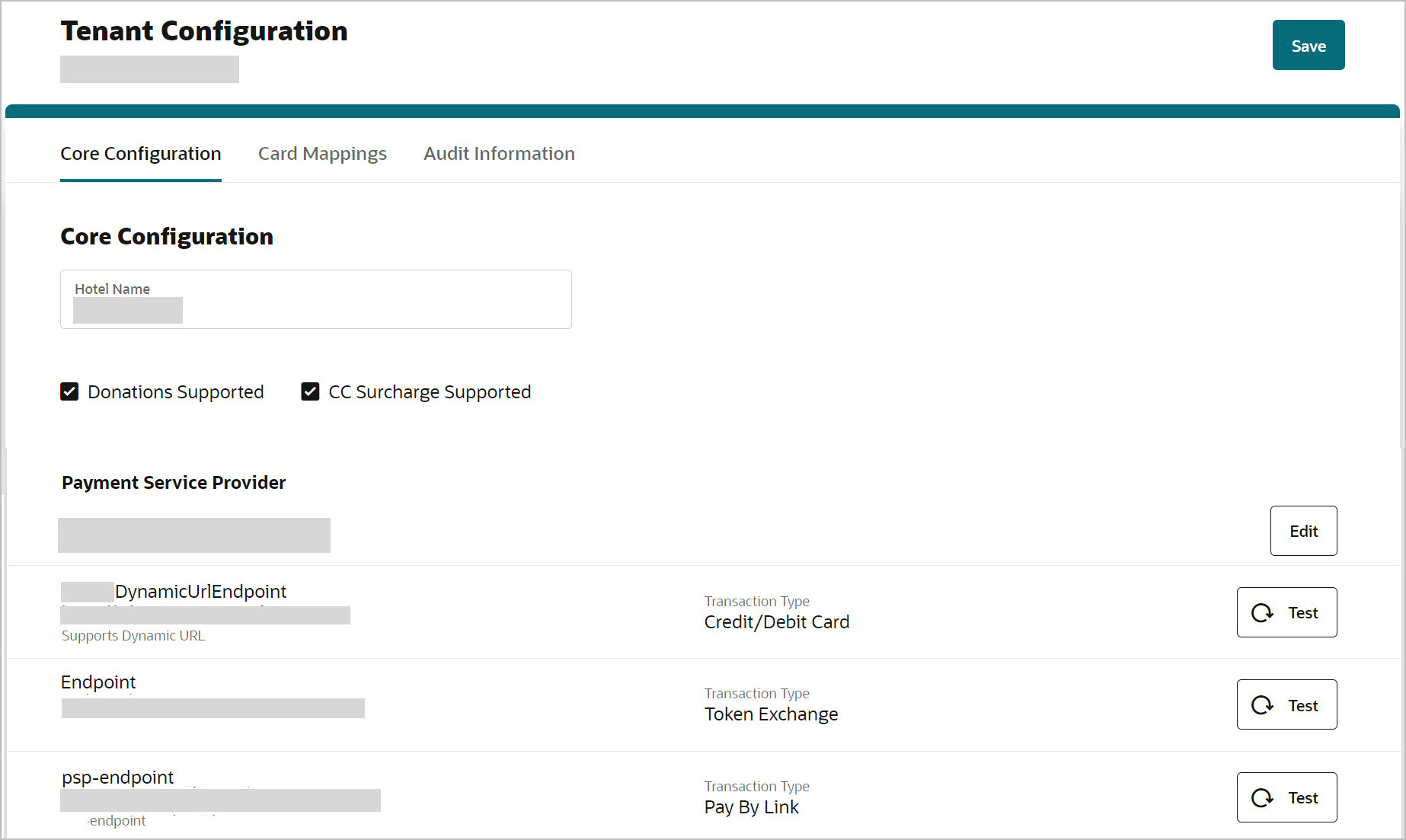

  1. The OPI Cloud Tenant Configuration portal landing page appears once you configure the property through OPERA Cloud.
    This image shows Tenant Core configuration screen
  2. Hotel Name: Enter the Hotel name. The hotel name can be either the name of the hotel or the OPERA Resort ID (this field is for information only).
  3. Donations Supported: If the check box is selected that means the Donation is supported by PMS. If the check box is not selected that means the Donation is not supported.
  4. CC Surcharge Supported: If the check box is selected that means the Credit Card Surcharge is supported by PMS. If the check box is not selected that means Credit Card Surcharge is not supported.
    • OPERA Cloud does not support the Donations or Credit Card Surcharge Support through OPI Cloud at this time.
    • The Save option allows you to save the Core Configuration only after the Payment Service Provider is selected.

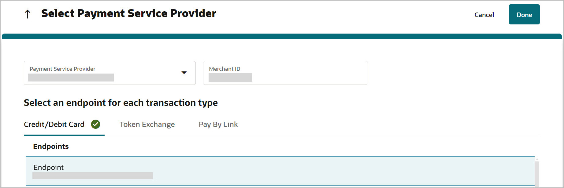

  5. Under the Payment Service Provider header, click Select to navigate to the Select Payment Service Provider screen.
  6. Select the Payment Service Provider from the list.
    Once the PSP is selected, the lists of configured endpoints for each transaction type are displayed. The screen will be one of two variations you see below:
    The screen appears with Custom Headers.
    This image shows selecting the Payment Service Provider
    The screen appears without Custom Headers.
    This image shows selecting the Payment Service Provider without Custom Headers
  7. Merchant ID: Enter the Merchant ID.

  10. Select an endpoint for each transaction type (Credit/Debit Card, Token Exchange, or Pay By Link) from the Endpoints list.

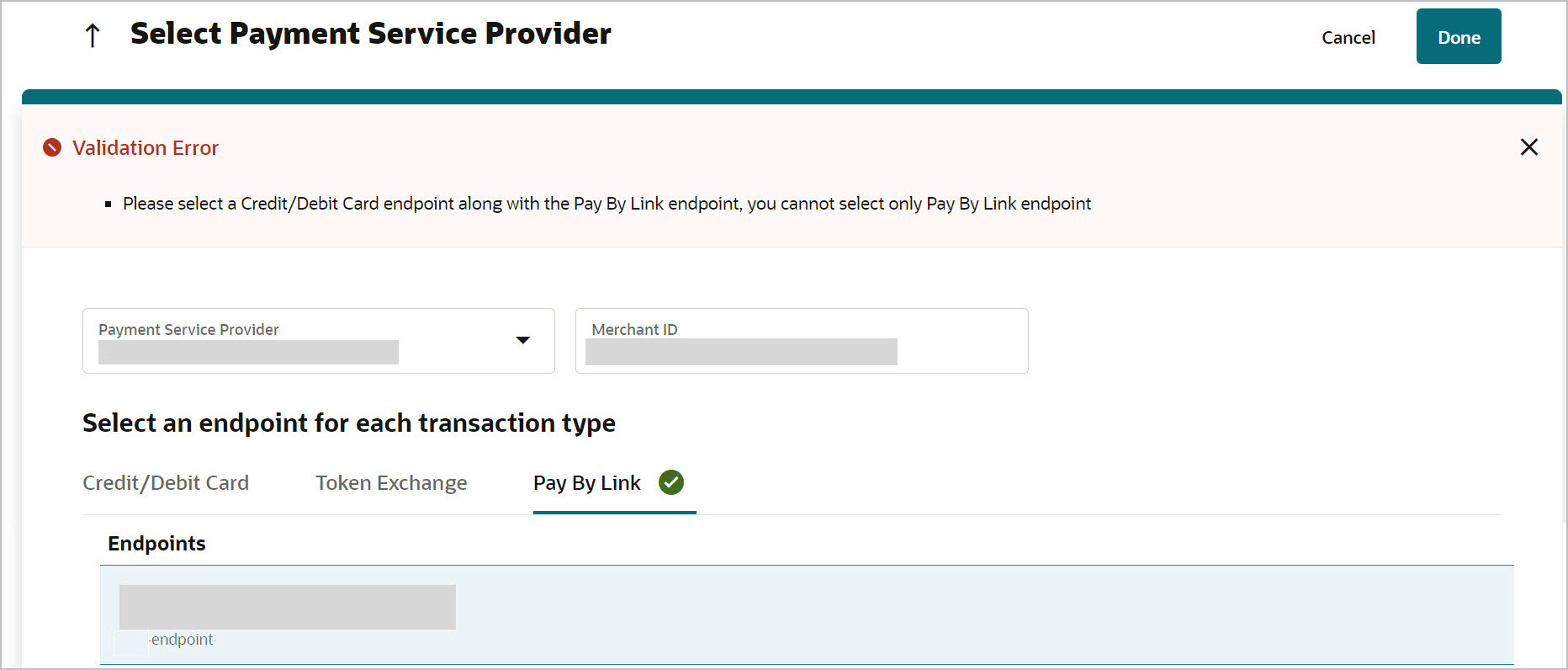

    • A tenant can be configured with a Pay by Link endpoint only if it is configured with a Credit Card endpoint. The Pay by Link endpoint can be configured along with the Credit Card endpoint, as the Pay by Link payment response includes a token that will be used in the future.
    • If a tenant is not configured with the Credit Card endpoint along with the Pay by Link endpoint, the system displays a message saying, ‘Please select a Credit/Debit Card endpoint along with the Pay By Link endpoint, you cannot select only Pay By Link endpoint’.
      This image shows the Validation error screen
    You can use the up arrow Up arrow icon icon to navigate to Tenant Core Configuration screen.
    This image shows selecting an endpoint for Credit Card, Token exchange, or Pay by Link transaction type
    This image shows selecting an endpoint for Credit Card, Token exchange, or Pay by Link transaction type with Custom Headers
    Once the endpoints are selected for each transaction type, you will see a tick mark next to the Transaction Type (Credit/Debit Card, Token Exchange, or Pay by Link).
  11. Click Done.
    The Tenant Core Configuration screen appears with mapped PSP endpoints.
    This image shows Tenant Core Configuration screen appears with mapped PSP endpoints.

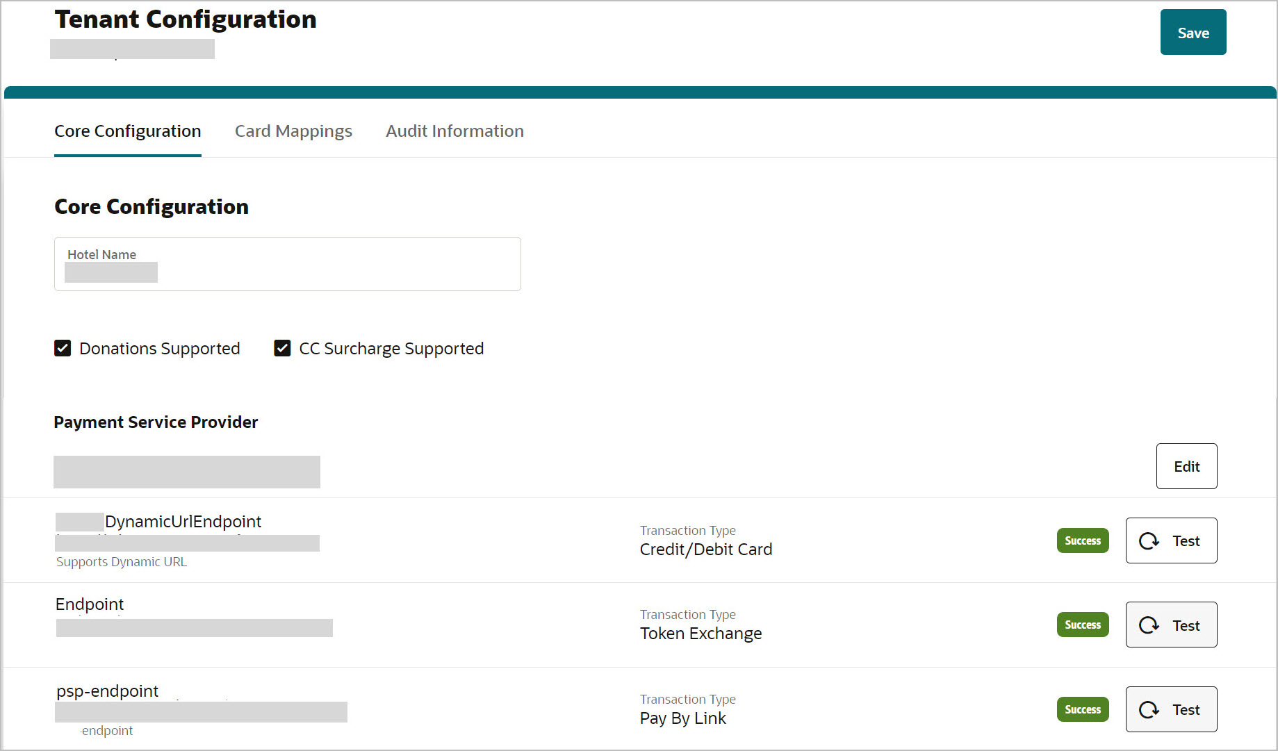

  12. Click the Test Test icon icon to test the endpoint connectivity.
    • If the PSP endpoint test is successful, the connection is successful.
    • If the PSP endpoint test is unsuccessful, the connection fails.
      If a test fails, you need to access the OPI Cloud logs to review the issue.
    This image shows PSP endpoint test connectivity
  13. Click Save and you will see a confirmation that Core Configuration has been updated successfully.
    Whenever you are trying to update any of the fields, you will see a message ‘Configuration update may take up to 15 mins to reflect in runtime’.
