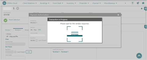

Upon Terminal Selection:-
The payment device will alert the customer to present the card.
After the guest inserts/swipes a card, a Token / Authorization request is automatically initiated.
A Token, Card Type, Expiration, and last 4 digits of the card number are successfully returned along with a successful authorization.
Upon successful authorization, the guest will be checked in.
The authorization is processed and appears in the Payment Authorization window as shown in the image below.

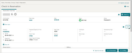

The guest is checked in successfully. To review the guest’s reservation information, click Go to Reservation.
