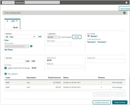

    The Folio Settlement confirmation screen appears.

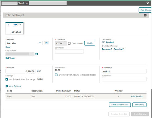

  4. Verify the card information on file:
    1. If replacing the main card with a new card, update the payment method, verify the amount, and click Settle and Send Folio. This step triggers the Payment device.
    2. If using the same card on file, proceed with the below steps.
  5. Verify theAmount to be settled and click Settle and Send Folio.
    This image shows the check out early screen

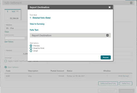

  6. Select the Destination option for the folio, and then click Process to view the report.
    This image shows the report destination menu
