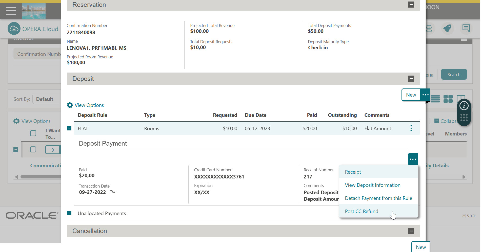

  3. Click I Want To… and select Deposit / Cancellation.

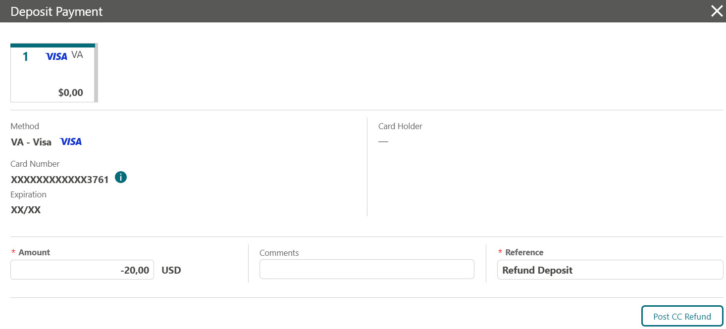

    The Deposit Payment screen displays the original payment method used for the transaction, which cannot be modified. You can modify the Amount field to a lower or higher value. During the refund process, OPERA Cloud performs rebate validation (comparing the entered amount with the previous amount charged to the credit card token) if the Credit Card Rebate Validation OPERA Control is enabled. If this OPERA Control is disabled, OPERA Cloud skips the rebate validation.
  4. In the Deposit Payment panel, click Post CC Refund for the deposit payments made using the credit card payment method.
    This image shows how to create a new deposit.
  5. Enter a lower or higher value in the Amount field.
  6. Provide Reference details, if any. This field is mandatory for refunds in OPERA Cloud.
  7. Click Post CC Refund.
    This image shows saving the deposit amount

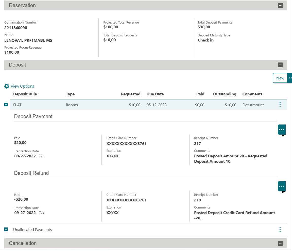

  8. The Deposit refund transaction is posted below the deposit payment, and the reservation balance is adjusted accordingly based on the refund transaction.
    This image shows the Deposit credit card refund amount is processed.
