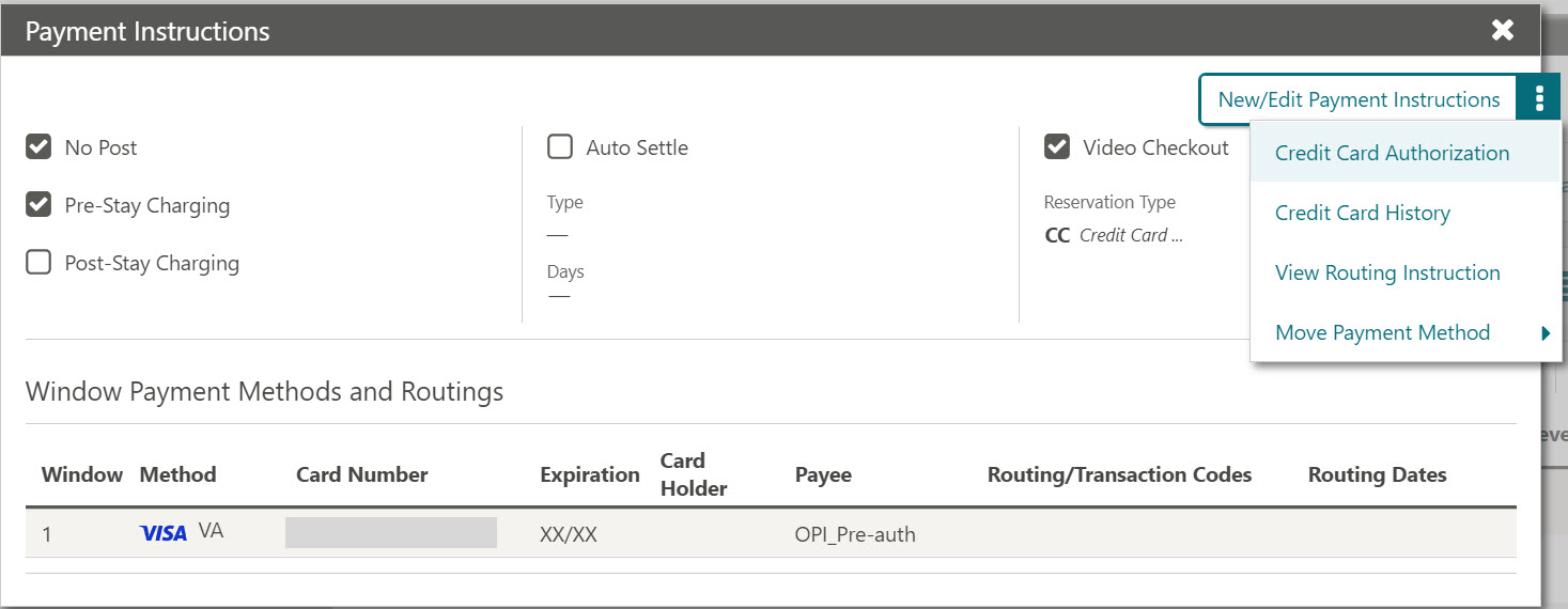

Click I Want To… and select Payment Instructions. See Payment Instructions for details.
Click the vertical ellipsis, and select Credit Card Authorization.

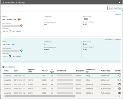

The Authorization and History screen appears.
Select the Additional option to obtain additional authorization amount on the required payment method or window.
Enter the Authorization Amount.
Click Run Additional Authorization.
The payment processing screen appears.
Confirmation of posted authorization appears in theAuthorization and History screen.
