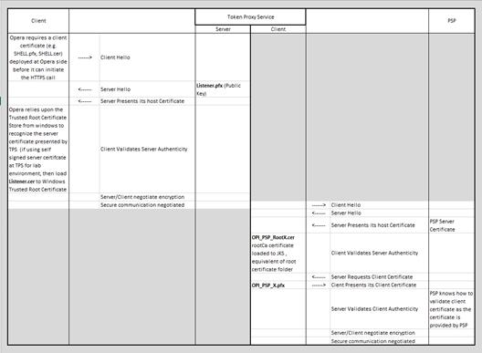

HTTPS is mandatory for the communication between OPERA and TPS and between TPS and PSP, therefore certificates are required to set up for each of the communication path.
The below diagram depicts the certificates used for each of the communication path during a transaction.
Important: Please note that a Public SSL certificate is required. If you attempt to install OPI TPS with a self-signed certificate then you will receive a warning.
This image shows the certificates used for each of the communication path during a transaction.
