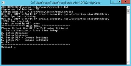

8 OPIConfigX.exe
Initialization/First Time Setup: Runs all options consecutively (If you plan to use certificate manager to set up certificates, then you can skip this option because you will only need to use OPIConfigX to set up the database).

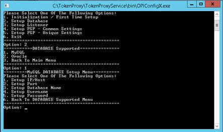

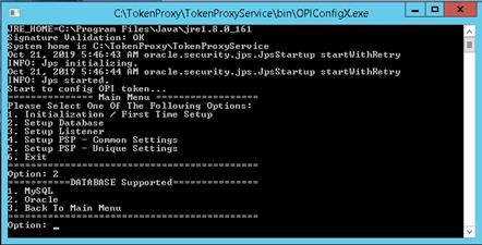

Setup Database: Configures the Token Proxy Service configuration for the MySQL or Oracle Database. This option does not change the User or Password at the database side, it only updates the Token Proxy Service configuration. The Database configuration change should be made by the database administrator.
Select either MySQL or Oracle Database option.
The below options are available for both MySQL and Oracle Databases:-
Setup IP/Host: The IP address of the MySQL or Oracle Database.
Setup Port: The port number of the MySQL or Oracle Database.
Setup Database Name: The Token Proxy Service database name created during installation.
Setup Username: The username for the Token Proxy Service database created during installation.
Setup Password: The password for the Token Proxy Service database created during installation.

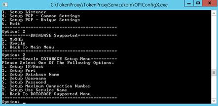

These two options are available only if you select Oracle Database.-
Setup Maximum Connection Number: The default is 40.
Setup Use Service Name: If connecting to an Oracle Pluggable Database, the service name should be used.

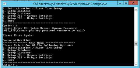

Setup Listener, Setup PSP – Common Settings and Setup PSP – Unique Settings: Use certificate manager to set up certificates of the Listener and the password of the common and unique PSP certificates. Refer to the Certificate Requests using Cert Manager section for more details.
If the database and PSPs have been configured properly in the Web Portal, then select the number for the PSP certificate password you want to set.
