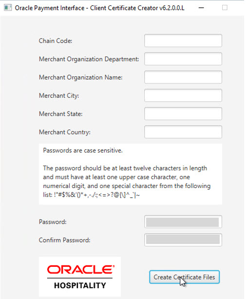

Run CertCreator.jar, and then add the required information.
Click Create Certificate Files when complete.
Specify the location to save the certificates, enter the filename, and then click Save.
Both a .pfx and .cer are created in the specified location.
The certificate expires five years from the date of creation.

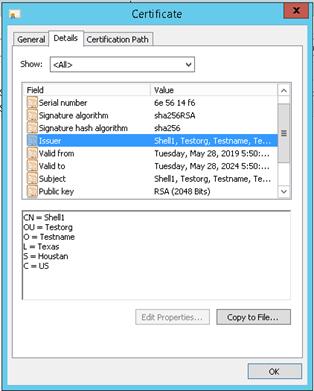

The OPI Client Certificate Creator fields translate to standard certificate attributes as follows:
Chain Code > CN (CommonName)
Merchant Organization Department > OU (OrganizationalUnit)
Merchant Organization Name > O (Organization)
Merchant City > L (Locality)
Merchant State > S (StateOrProvinceName)
Merchant Country > C (CountryName)
