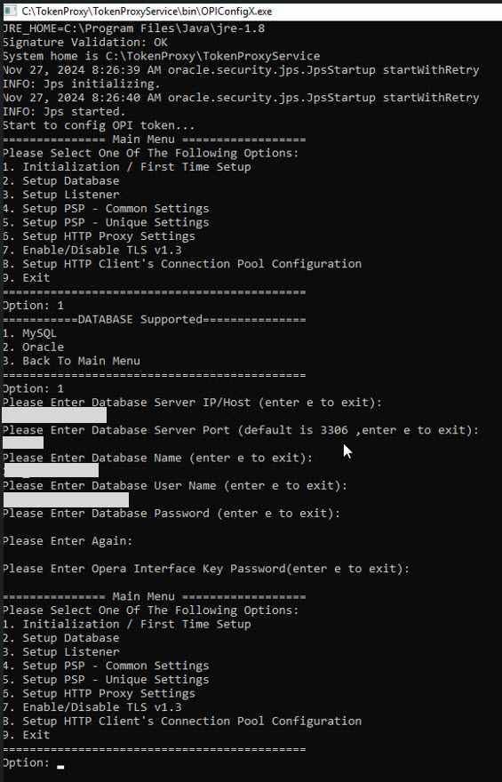

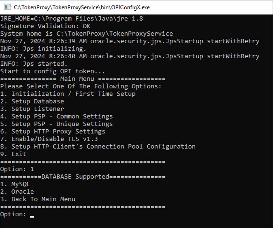

8 OPIConfigX.exe
Initialization/First Time Setup: Runs all options consecutively (If you plan to use certificate manager to set up certificates, then you can skip this option because you will only need to use OPIConfigX to set up the database).
Setup Database: Configures the Token Proxy Service configuration for the MySQL or Oracle Database. This option does not change the User or Password at the database side, it only updates the Token Proxy Service configuration. The Database configuration change should be made by the database administrator.
Select either MySQL or Oracle Database option.
The below options are available for both MySQL and Oracle Databases:-
Database Server Setup IP/Host: The IP address of the MySQL or Oracle Database.
Database Server Port: The port number of the MySQL or Oracle Database.
Database Name: The Token Proxy Service database name created during installation.
Database User Name: The username for the Token Proxy Service database created during installation.
Database Password: The password for the Token Proxy Service database created during installation.
These two options are available only if you select Oracle Database.-
Setup Maximum Connection Number: The default is 40.
Setup Use Service Name: If connecting to an Oracle Pluggable Database, the service name should be used.
Setup Listener, Setup PSP – Common Settings andSetup PSP – Unique Settings: Use certificate manager to set up certificates of the Listener and the password of the common and unique PSP certificates. Refer to the Certificate Requests using Cert Manager section for more details.
If the database and PSPs have been configured properly in the Web Portal, then select the number for the PSP certificate password you want to set.
Setup HTTP Proxy Settings: Use this option for setting up proxy settings.
Enable/Disable TLS v1.3: Use this option for enabling/disabling TLS v1.3. TLS v1.3 is set as default value in the application. If this option is disabled, the application uses TLS v1.2 irrespective of the flag.
Setup HTTP Client’s Connection Pool Configuration: Use this option for setting up HTTP Client’s connection pool configuration.
Exit: Exits the OPIConfigX utility.
