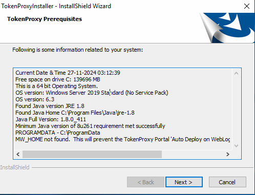

The installer verifies system compatibility and looks for the MW_HOME environment variable to use when deploying the WebLogic configuration. The installer allows you to proceed without the MW_HOME variable, but doing so limits the WebLogic deployment tasks the installer can complete. The MW_HOME variable is not mandatory because you can install the Token Proxy Service by using Tomcat which allows deployment of Token Proxy WebPortal on Tomcat.
If the MW_HOME is not found, then the installer will prevent the Token Proxy Portal Auto Deployment on WebLogic server. -
Click Next to proceed with the installation.
Ensure all the prerequisites for the Token Proxy installation are met.

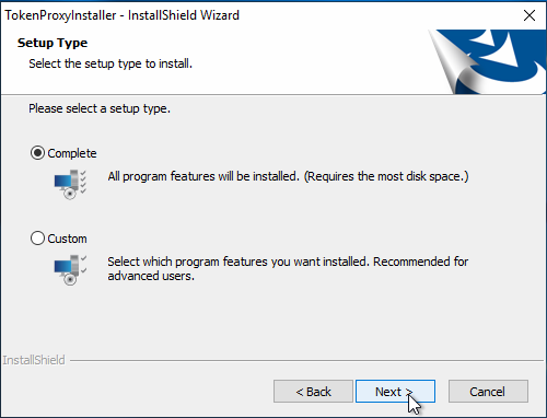

Select either the Complete or Custom installation option:
Complete: Installs the Database, Token Proxy Web Portal and Token Proxy Service during the installation process.
Custom: Allows installation of only the modules selected. You can also use this mode to install Token Proxy Service only on multiple servers if they want to deploy multiple TPS servers behind a load balancer for high availability. For example, if you want to install the Database on one host and the WebPortal on a different host, you can run the installer on both the machines, with only the relevant components selected for each machine.

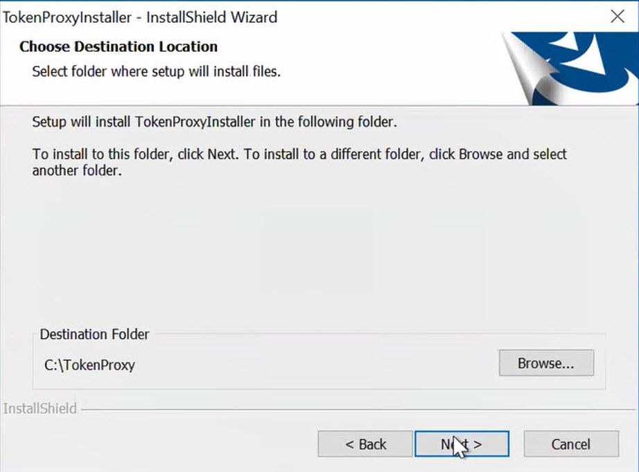

Click Browse to amend the installation drive or Token Proxy installation path, if required and then click Next.
Click Install to begin the installation.

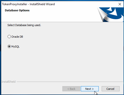

Select your Database type:
MySQL
Oracle DB
Click Next.

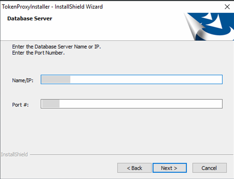

On the Database Server screen, enter the following credentials to allow the Token Proxy Service installer to connect to your Oracle 12c/19c or MySQL Database. The installer supports pluggable and legacy non-pluggable database formats.
MySQL
Name/IP: The Hostname or IP Address used for communication to the database. If the TPS and its database are installed on the same host machine, then you can enter the value as ‘localhost’ here.
Port #: The Port number used for communication to the database.
Oracle DB
Name/IP: The Hostname or IP Address used for communication to the database. If the TPS and its database are installed on the same host machine, you can enter the value as ‘localhost’ here.
Service Name: The service name used to connect to the Oracle database.
Click Next.

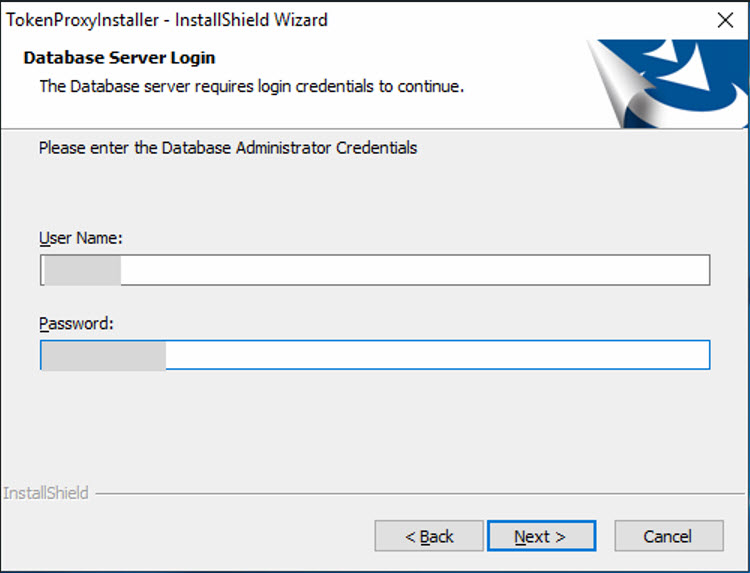

Enter the database credentials. The installer requires DBA access to create a Token Proxy Service database user and configure a Token Proxy Service database schema.
For MySQL the Login ID: = root
For Oracle database, enter the DBA user name or Login ID.
Enter the correct password for the DBA user.
Click Next.

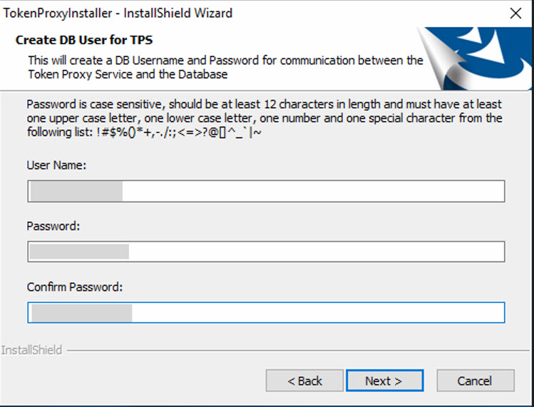

Enter the following details.
User Name: Create a new user. When creating the username for the database, the installer allows only alphanumeric characters and should start only with an alphabetic character.
Password: Create a password. The Password is case sensitive, and should be at least 8 characters in length and must have at least one upper case letter, one lower case letter, one number and one special character from the following list:!@#$%^&*
Confirm the password, and then click Next.

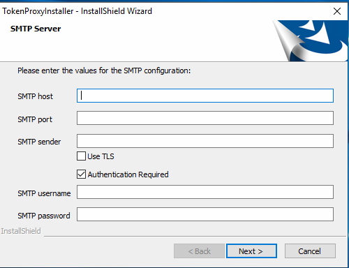

Enter the SMTP server details. The Token Proxy Service requires access to SMTP server in order to send password reset emails.
SMTP host: Your SMTP mail server address.
SMTP port: Your SMTP mail server port.
SMTP sender: The email address that any password reset emails will show as sent from.
Use TLS: Select this option if the SMTP server supports TLS secured connections for sending login credentials. Enable this option in a production environment, if supported.
Authentication Required: Select this option if the SMTP server requires username and password credentials to send email. If not required, uncheck this option and ignore the smtp.username and smtp.password fields.
SMTP username: If ‘Authentication Required’ is selected, set the username of the SMTP credentials.
SMTP password: If ‘Authentication Required’ is selected, set the password of the SMTP credentials.
Click Next.
