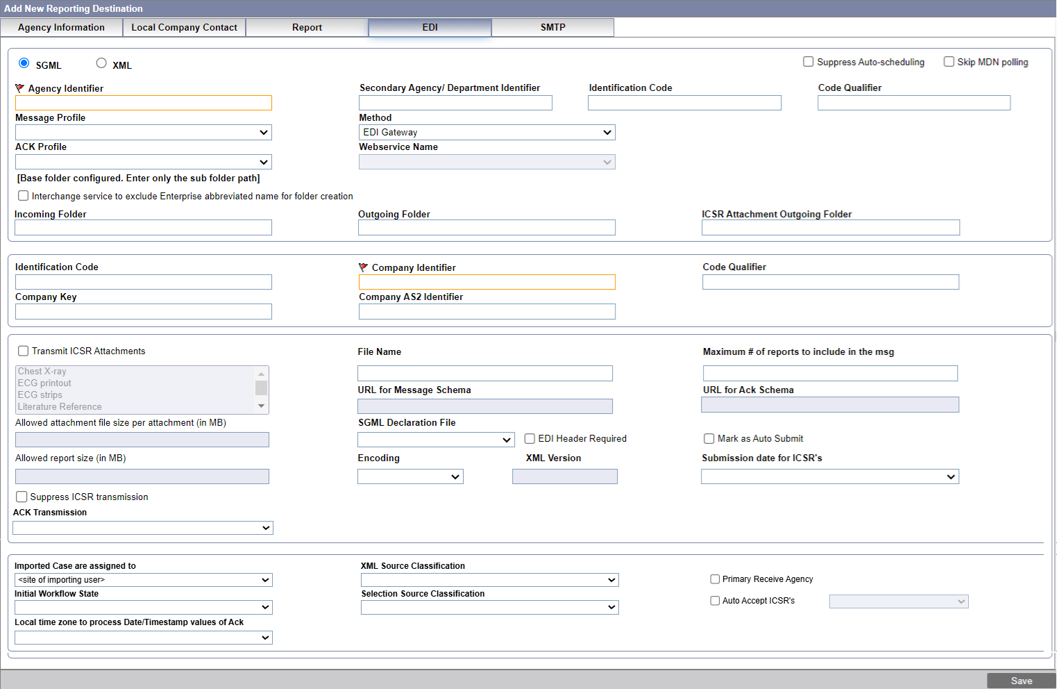

Configuring EDI
Field Descriptions
This section lists the field descriptions and configuration steps for the EDI tab.
Configuring EDI screen
The following table lists and describes the fields on the EDI tab.
