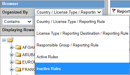

About the Filtering Criterion
The filtering criterion is essential as it helps you to search for specific items. The Argus Console provides this option for the Business Configuration section.
Using Organized by
The filtering browser is displayed in the top-left corner of the left panel. The Expedited Report Rules section can be filtered on the basis of any of the five combinations shown in the following illustration.
Using Organized By options
Consider the following examples:
  • If you enable Organized by Country/License Type/Reporting Rule, then the output generated will be visible in a tree-format, in the left panel, based on the entire categorization of Country, License Type and Reporting Rule.
  • If you enable the Organized by Responsible Group/Reporting Rule, then only the Responsible Group and Reporting Rule views will be available in the tree view in the left panel.
Tip:
  • Enable the Organized By filter for Active Rules, to obtain the list of active reporting rules.
  • Enable the Organized By filter for Inactive Rules, to obtain the list of inactive reporting rules
The Argus Console helps you to filter information further for the Business Configuration section. Once you have selected the Organized by, you can specify whether your search should contain or start with specific alphabets or words.
For example, the filtering criterion defined in the following illustration for all Country/License Type/Reporting Rule data that contain the term Canada.
Using Organized By options 2
