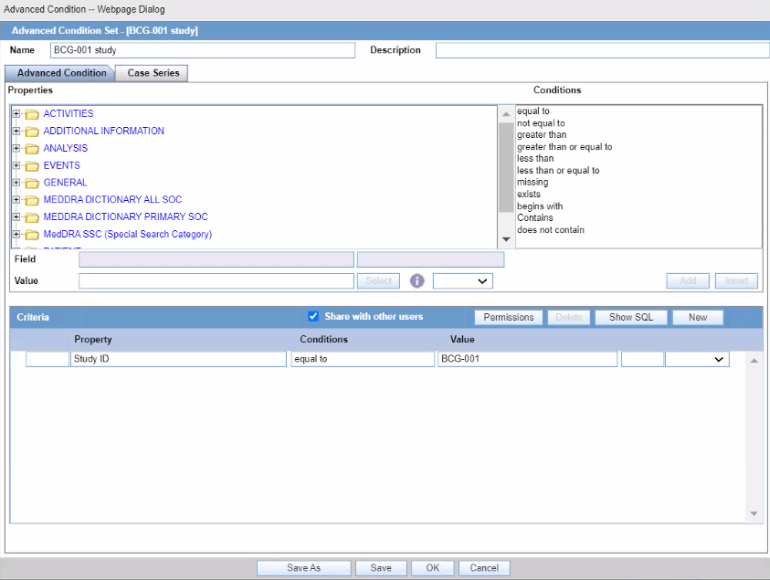

 - If you select No, the Advanced Condition Set dialog is displayed.
The Advanced Condition Set dialog enables you to search for those entities under the Properties tree-list, which are from either the case data or from the code list. For this, the dialog provides two radio buttons - From Code List and From Case Data.- Select the relevant entity and one of the radio buttons, as applicable.

 - Select a property type from the Properties tree list.
The items available under the folders in the Properties list represent those fields on the Case Form that can be used to perform the search in the advanced conditions.
When a Property for which terms can be encoded is selected, the Select button is enabled. You can use the MedDRA Browser to select (possibly) multiple terms for the property.An SMQ icon is enabled when the SMQ-related properties are selected from the Properties tree-list. Click this icon to view the SMQ Info dialog. The SMQ Info dialog contains details about the selected SMQ.
 - In the Conditions list, select a condition that must apply to the item selected
                    above.
The available conditions are "equal to", "contains", "less than", "greater than", "not equal to", "missing", "greater than or equal to", "less than or equal to", "exists", "does not contain" or "begins with".
 - Under Value, enter the value which will apply to the property, or select an appropriate value from the list, as applicable.

The logical operators that can be used to link the existing condition to a new condition are AND/OR. - Click Add to add the newly created condition to the advanced condition.
 - Repeat steps 2 through 6 to add more conditions to the advanced condition.
 - When each of the required conditions for the advanced condition is entered, click Save.
 - Enter a name for the advanced condition and click
                    OK.
