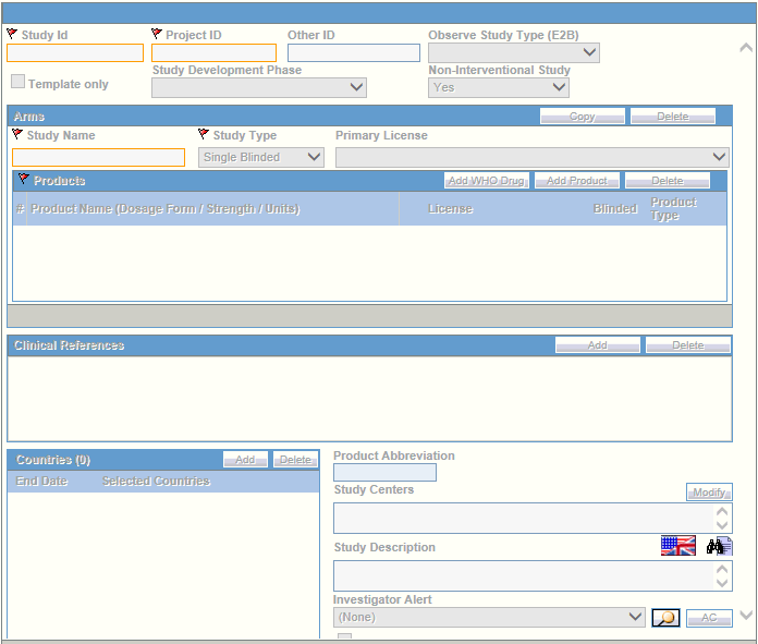

The following illustration shows the fields associated with this section.
