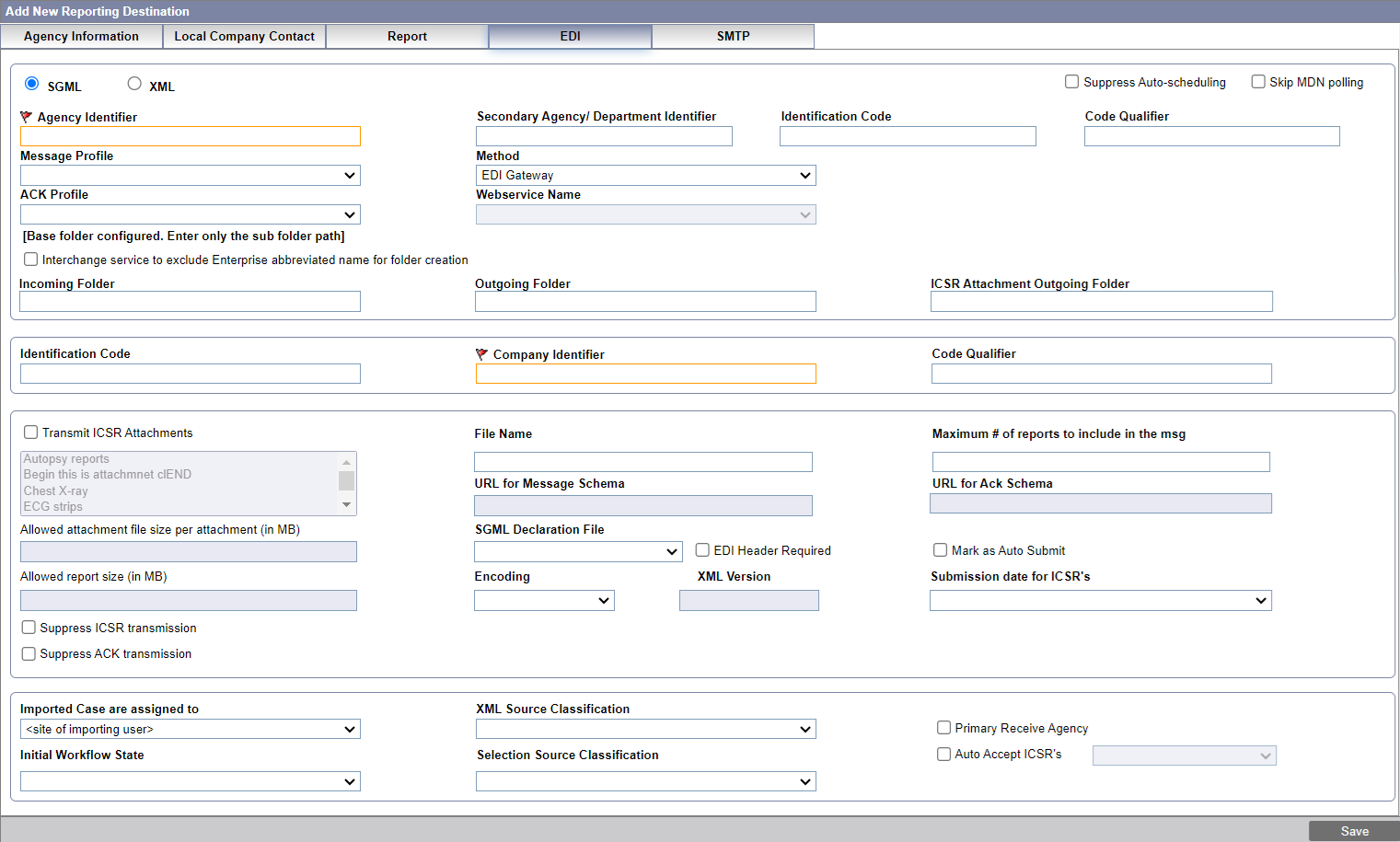

Configuring EDI
Field Descriptions
This section lists the field descriptions and configuration steps for the EDI tab.
Configuring EDI screen
The following table lists and describes the fields on the EDI tab.

SGML/XML
Enables you to select whether to send the report in SGML or XML format. When the E2B(R3) Message profile is selected, then the XML radio button is selected by default and both SGML and XML radio buttons are displayed in read-only mode.
Suppress ICSR transmission
Enables you to allow to suppress ICSR transmission.
By default, this option is not checked.
Suppress ACK transmission
Enables you to allow to suppress the acknowledgment transmission.
Skip MDN polling
Enables you to allow to skip MDN polling for a given reporting destination.
Agency Identifier
Enables you to enter the routing ID configured in gateway for the sender community.
Secondary Agency/ Department Identifier Enables you to enter Message Receiver Identifier information.
The Mesage Receiver Identifier is the internal department within the agency which receives the report.
For new and pre-existing destinations, this field is set to blank by default.
Identification Code
Enables you to enter the agency Duns code, a unique identification code that identifies the trading partner.
This field is disabled for the E2B(R3), eVAERS, MIR, and eMDR profile. Populated with default values and is displayed in the read-only mode for the PMDA E2B R3 profile.
Code Qualifier
Enables you to enter the code qualifier here. The code qualifier is used to interpret the identification code.
This field is disabled for the E2B(R3), eVAERS, MIR, eMDR, and PMDA E2B(R3) profiles.
Message Profile
Enables you to select a message profile among the list of message profiles displayed.
Mark as Auto Submit
Enables you to mark the report for auto submission.
Auto Accept ICSRs
Click this checkbox to auto accept ICSRs. This checkbox is visible only when case numbering is set to Automatic.
Submission date for ICSRs
Enables you to select the submission date for ICSRs. It is blanked out and disabled if user selects the eVAERS or eMDR profile in the EDI Tab.
ACK Profile
Enables you to select the acknowledgement profile. This field is disabled for the eMDR, MIR, and eVAERS profile. The PMDA E2B(R2) Ack profile is also available now.
Primary Receive Agency
Enables you to select the primary receiving agency.
Imported Cases are assigned to
Enables you to select the sites, where the imported cases need to be assigned.
This list comprises the configured Argus sites. The default value is the site of the importing user.
Initial Workflow State
Enables you to configure the initial workflow state of the case.
This list comprises Argus workflow states, with the default value being blank. If you select blank as the workflow state, it is treated as a new case being booked-in.
XML Source Classification
The system enables you to configure the XML Source Classification and the PDF Source Classifications used for classifications defined while the Source E2B File / PDF for Initial Intake or E2B Differences report is classified.
When a case is accepted as an initial or follow-up case, the system attaches the source XML and the Initial Selection PDF to the case on the Additional Info tab.
This field is disabled for the MIR profile.
Selection Source Classification
Enables you to select the source classification from the drop-down.
Transmit ICSR Attachments
Click this checkbox to transmit E2B attachments. If this checkbox is checked in the Reporting Destination Code List, case form attachments are sent to the specified reporting destination.
Attachment Classification
Enables you to select the attachment classification.
Local Company Contact Identification Code
Enables you to enter the company Duns code, a unique identification code that identifies the trading partner. This field is disabled for the E2B(R3), eVAERS, MIR, and eMDR profile.
Company Identifier
Enables you to enter the company identifier.
Code Qualifier
Enables you to enter the code qualifier here. The code qualifier is used to interpret the identification code. This field is disabled for the E2B(R3), eVAERS, MIR, and eMDR profile.
File Name
Enables you to specify the file name format for the files created by Interchange.
SGML Declaration File
Enables you to enter the SGML Declaration File. This field is disabled for the E2B(R3), eVAERS, MIR, and eMDR profile.
Maximum # of reports to include in the msg
Enables you to enter the maximum number of reports that will be transmitted in one message. This field is disabled for the eVAERS, MIR, eMDR, and PMDA Device profiles, and set to 1. This parameter can be used for English E2B(R2) reports. But in case of PMDA E2B(R2), this parameter should be left blank or set to 1.
By default, when a new agency is created, this field appears as NULL for the profile selected as R3.
Method
Enables you to specify the method of submitting the report: Physical Media, Web services, or EDI Gateway.
Webservice Name
Enables you to select the webservice name configured in the system configuration.
This drop-down is enabled only when Method is selected as Web Service.
You must select MFDS as the web service name. If you select Interchange profile other than MFDS, an error message appears as only MFDS is configured as the message profile for web service.
EDI Header Required
Enables you to generate the EDI Header. This field is disabled for the E2B(R3), eVAERS, MIR, and eMDR profile. Populated with default values and is displayed in the read-only mode for the PMDA E2B(R3) profile.
XML Version
Enables you to enter the XML Version. This field is disabled for the E2B(R3), MIR, and eMDR profile and set to 1.0. Populated with default values and is displayed in the read-only mode for the PMDA E2B(R3) profile.
URL for Message Schema
Enables you to enter the path where the message schema resides on the internet or enter full path if it is located on the disk. This field is disabled for the E2B(R3), eVAERS, MIR, and eMDR profile. Populated with default values and is displayed in the read-only mode for the PMDA E2B(R3) profile.
Encoding
Enables you to select the character set encoding used in XML. This field is disabled for the E2B(R3), eVAERS, MIR, and eMDR profile and set to UTF-8. Populated with default values and is displayed in the read-only mode for the PMDA E2B(R3) profile.
Allowed attachment file size per attachment (in MB)
Enables you to specify allowed attachment file size (in MB) for each attachment.
Allowed Report Size (in MB)
Enables you to specify allowed Report size (in MB).
URL of ACK Schema
Enables you to enter the path where the ACK schema resides on the internet or enter the full path if it is located on the disk. This field is disabled for the E2B(R3), eVAERS, and eMDR profile.
Interchange service to exclude Enterprise abbreviated name for folder creation
This checkbox appears only when the Base directory path for gateway folders common profile switch is configured with a base folder path. For more information on the base directory path, see Configuring the Base Directory Path.
When this checkbox is unchecked, the Interchange service inserts the enterprise abbreviate name in the folder creation, resulting in folder structure, such as Base folder path\Enterprise abbreviate name\Sub folder path configured in Agency
When this checkbox is checked, the Interchange service does NOT inserts the enterprise abbreviate name in the folder creation, resulting in folder structure, such as Base folder path\Sub folder path configured in Agency
When this checkbox is marked for a new Reporting Destination, by default, the enterprise abbreviated name is populated in the fields as per the following format:
  • Incoming Folder: Enterprise abbreviated name\Agency Name\Incoming
  • Outgoing Folder: Enterprise abbreviated name\Agency Name\Outgoing
  • ICSR Attachment Outgoing Folder: Enterprise abbreviated name\Agency Name\OutAttachment
If this flag is set for an existing Reporting Destination that has folders configured, the existing folders are retained. You can manually update the sub-folder as desired, or clear sub-folder path and tab out of Agency Name field to get the folder path auto populated as mentioned above.
Incoming Folder
Enter the path to the folder where incoming files are stored.
For more information on the format of the folder creation path, see Configuring the Base Directory Path
Outgoing Folder
Enter the path to the folder where outgoing files are stored.
Enables you to select the primary receiving agency that is used during ICSR import when there are multiple agencies with the same agency and company identifiers.
This field is enabled only for E2B (R2) profiles.
Suppress Auto-scheduling
If the checkbox for Suppress Auto-scheduling is marked for an Agency in the Reporting Destination codelist, the system does not schedule reports (Initial, Follow-up, Amendment, Nullification) for that specific Agency during Auto-scheduling (via AG services, Clicking on Auto-scheduling, Auto-scheduling of f/p reports for a manually submitted report). However, reports can be manually scheduled to the Agency that is set for Suppress Auto-scheduling.
Allow multiple reports for Investigational Drugs (Clinical Trial)
Enables you to schedule a report for each suspected Investigational drug for the case.
The reporting categories applicable for this check box are DA, DB, DC and DD.
By default, this check box is unchecked.
This field is applicable for PMDA reports only. Do not check this option for non-PMDA reports.
Allow multiple reports for Investigational Drugs (Research and Measure)
The reporting categories applicable for this check box are DE, DF, DG.
The check box is unchecked by default.
Allow Multiple Reports for Marketed drugs
Enables you to schedule a report for each marketed drug for the case.
