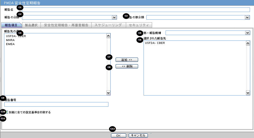

PSR/ReSD Details
Subject of Report
Field Name | Description |
Report Name |
Manually Input a Name for the Report. It is displayed in the Reports > PSR Reports dialog box. |
Report Category |
Manually Input a Name for a Report Category. It is displayed in the Reports > PSR Reports dialog box. |
Primary Report Agency |
This list contains the Regulatory Authorities configured in List Maintenance > Regulatory Authorities (LM_REGULATORY_CONTACT table). If there is no Japanese Authority name configured, the English name is listed. The system allows you to select multiple agencies from the List of Agencies such that the report can be submitted to multiple agencies at the same time.The primary agency can be defined in this drop- down.When Japanese Message Profile is not configured in Console J for the selected Primary Agency, or when you add the agency with PMDA E2B (R3) or (R2) in the Report Configuration, an error message is displayed as: Selected Primary Agency doesn't have configured Message Profile (I or J) in Argus Console > Reporting Destination/EDI. Once you click OK, the selection of the Primary Agency goes back to the previous selection. This check is executed when you try to go to the other tab, or click OK to save the configuration. |
Report Number |
Manual entry text field that allows you to enter a report number. |
Print all configuration criteria on separate cover page |
Check box to print out the configuration of this report when the report is printed. When this is clicked, the Configuration page is printed at the beginning of the PSR/ReSD word print output. The page numbering of the PSR/ReSD does not include the Configuration page. |

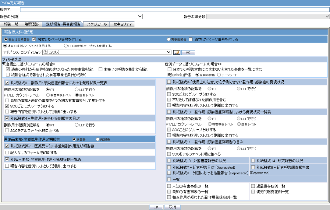

Periodic Safety Report/ReSD
Forms configuration |
This field represents the main title of the UI. |
Periodic Safety Report |
This radio button is available to select either PSR or ReSD, so that you can create PSR and ReSD independently.This is selected as Default |
Re-examination Submission Dossier |
This radio button is available to select either PSR or ReSD, so that you can create PSR and ReSD independently. |
Data counting configuration
Count Configuration |
NA |
Exclude events which don't meet the condition from the past data |
When this is checked, the events that were reported in the past PSR, but do not meet the condition at the end of current investigational timeframe are subtractedEvent was downgradedReport was nullifiedWhen this occurs, following message is printed under the first table of form 3: Among the Events that were count in the past report, there are nullified/became non-reportable during this investigational time frame. This is not checked by default. |
Exclude events which were reported by Paper report form |
When this is checked, the events that were reported by Paper Form during the investigational time frame are excluded. This is always checked and disabled. |
Exclude Incompletion report from output |
When this is checked, the events reported as incompletion report during the investigational time frame are excluded. This is not checked by default. |
Include AE marked as Not include for the report in Japan |
When this is checked, the events in the cases that
have checkbox for "Not include for the report in Japan" (Case
Form > Japan Event tab > |
Listedness Assessed on |
When this is set to Case Assessment, Japanese marketed license listedness for the PSR products from the Case Form > Event Assessment tab is used for listedness determination. If the event is unlisted against at least one such license, it is printed as unlisted. "Unknown" is counted as "Unlisted". When this is set to Datasheet, Japanese marketed license datasheets for the PSR products as configured in Console at the time of PSR report generation is used for listedness determination. If the event is unlisted against at least one such license, it is printed as unlisted. A license is considered valid if it's Award Date <= End Date and Withdrawn Date >= Start Date. Blank Award Date or Withdrawn Date can be considered as valid. |
PSR Report Form 3
Form 3 Selection (check box) |
If this is checked, PSR Form3 is printed. This is checked by default. |
Print Only the Term Preferred Term (radio button)Lower Level (radio button) |
This field allows you to decide which term (PT or LLT) is to be printed on the form3.PT is selected by default. |
PT/LLT Count Level |
If Event based count is selected, if same PT/LLT code appears in the case/E2B more than once then it is counted that many times. If Case based count is selected, if same PT/LLT code appears in the case/E2B more than once then it is counted as one. Infection count that is printed in the '()' follows the same logic as PT/LLT If the Event is marked as Infection for any of the entry case level is selected by default. |
Count Listed & Unlisted as two separate events |
If this is checked, if the same reaction is marked as Listed for one entry in the Case and Unlisted for the other entry then, it is counted as two separate Events. If this is unchecked, if the same reaction is marked as Listed for one entry in the Case and Unlisted for the other entry then, system goes with conservative approach and it is counted as Unlisted. This check box is enabled only if the "PT/LLT Count Level" is set to "Case Level Count". This is unchecked by default. |
Classify based on SOC |
If this is checked, the PSR Form 3 PT/LLT section is grouped by SOC. In this case, the name of the SOC is listed at top of the section, and --- is used for separator between SOC and PT/LLT. Bold line is used for separating the groups. This is checked by default. |
Print the report content as Case Listing in the separate paper |
When this is checked, the case listing of the report content is printed out on a separate paper. All the configuration reflects the case listing. This is not checked by default. |
PSR Report FORM 4
Form 4 Selection (check box) |
If this is checked, the PSR Form4 is printed. This is checked by default. |
Print Only the Term |
This field allows you to decide which term (PT or LLT)is to be printed on the form4.PT is selected by default. |
Order SOC Alphabetically (check box) |
If this is checked, the SOC is printed in alphabetical order. If not checked, the SOC order is same as that of the MedDRA order. This is not checked as default. |
Non-Serious Unlisted PSR Report
Drug Non-Serious, Unlisted PSR |
This field represents the title of the section. |
Paper ReportFD Report |
Radio buttons:When Paper Report is selected, Paper report format is generated.When FD Report is selected, CSV report format is generated.When FD report is selected, both 7-1 and 7-2 forms are checked in the checkboxes and these cannot be edited. Paper Report is selected by default. |
PSR Report FORM 7 - 1
Form 7-1 Selection (check box) |
If this is checked, the PSR Form7-1 is printed. This is checked by default. |
Print Blank Form |
By checking this, the blank form is printed. This is not checked by default. |
PSR Report FORM 7 - 2
Form 7-2 Selection (check box) |
If this is checked, the PSR Form7-2 is printed. This is checked by default. |
When this is checked, the Case listing of the report content is printed out on a separate paper. This is not checked by default. |
Separate Page Numbering (check box) |
When this is checked, the Page number is independent (starts from 1) for each form. This is checked by default. |
Use Current Case VersionUse DLP Case Version |
This radio button control is only displayed if DLP is enabled. Use Current Case Version is selected by default.Based on the PSR Configuration for DLP, the report is executed accordingly using latest Case Revision or using the DLP Case Revision. |
ReSD Report FORM 10
Form 10 Selection (check box) |
If this is checked, the ReSD Form 10 is printed. This is checked by default. |
Allows you to decide which term (PT or LLT) you want to print on Form 10.PT is selected by default. |
Allows you to filter the report based on the following options: Case Level Count (Default) Event Level Count Note: The data inclusion criteria for this column is same as PSR Form 3. |
If this is checked, the PSR Form 3 PT/LLT section is grouped by SOC. In this case, the name of the SOC is listed at the top of the section, and --- is used as separator between SOC and PT/LLT. Bold line is used for separating the groups. This is checked by default. |
When this is checked, Case Listing of the report content is printed out on a separate paper. This is NOT checked by default. |
ReSD Report FORM 11
Form 11 Selection (check box) |
If this is checked, the ReSD Form 11 is printed. This is checked by default. |
Allows you to decide which term (PT or LLT) is to be printed on form11. PT is selected by default. |
If this is checked, the SOC is printed in alphabetical order. If this is not checked, the SOC order is same as that of the MedDRA order. This is not checked by default. |
ReSD Report FORM 9
Form 9 Selection (check box) |
If this is checked, the ReSD Form 9 is printed. This is checked as default. |
This field allows you to decide which term (PT or LLT)is to be printed on the form 9. PT is selected by default. |
Include Reactions assessed as Unknown |
If this is checked, report includes all the Reactions where either the Assessment is Unlisted or Unknown or Blank. If this is unchecked, report includes all the Reactions where either of the Assessment is Unlisted. |
ReSD Report FORM 13
Form 13 Selection (check box) |
If this is checked, the ReSD Form 13 is printed. This is checked by default. |
ReSD Report FORM 14
Form 14 Selection (check box) |
If this is checked, the ReSD Form 14 is printed. This is checked by default. |
ReSD Report Tabulations
Tabulations |
If this is checked, all the tabulations in the section are checked and included in the print. This is checked by default. |
Tabulation for Unlisted Events |
When checked, this tabulation is included in the print. This is checked by default. |
Tabulation for Listed Events |
Case Overview Tabulations |
Overdose Tabulation |
Accident Exposure Tabulation |

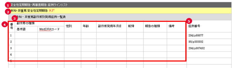

PSR Form 3 Case Line Listing
# | Field Name | Description |
1 |
PSR/ReSD Case Line Listing |
This field represents the section title. |
2 |
This field represents the 2nd title. |
3 |
Periodic Safety Report form #3 |

PSR Form 7 Case Line Listing
1 |
2 |
Non Serious, Unlisted Periodic Safety Report |
3 |
List of non-serious, Unlisted adverse event |
This field represents the title for Form 7-2 section. |
4 |
(form 7 body) |
This section is always same as the PSR form 7. |
5 |
Case Number |
The Argus case numbers are added using this field. |

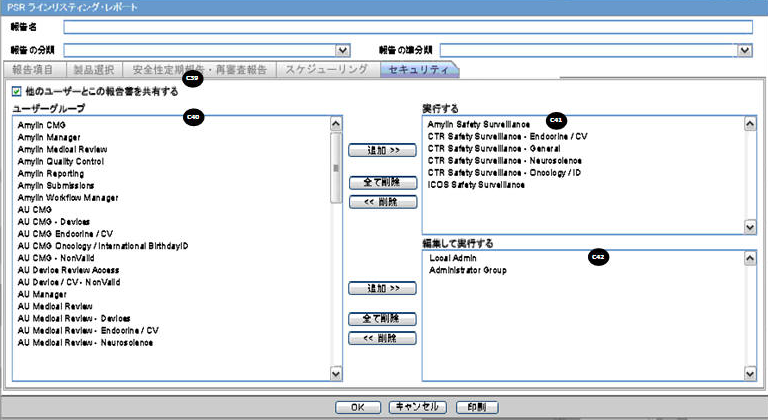

Security

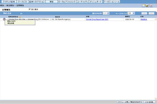

- From the Reports > Compliance > Periodic Reports, selecting View Report allows you to View the PSR/ReSD Report in Word document to upload the report.
- When the J user opens Reports >
Reports from the menu, the Japanese UI is displayed for
Periodic report list. The pop-ups for the PSR View and Edit are
Japanese.

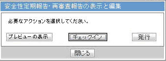

- When the report is generated and never checked out, the center button display Check-out to let you revise the document. At this time, Publish button is disabled.
- Check-out can be executed by one user only. Other users cannot check in the checked-out files.
- Once the check-out is executed, the Check-out button is changed to the Check-in button. This button is used to check-in the revised checkout file.
- When the file is checked-in, the center button is changes to the Check-out button.
- When the file is not checked-out or not published, you can check-in/check-out the file as many times as you want.
- When the file is not checked-out or not published, the group which has the access rights to this report can execute the check-in, check-out, and publish.
- The View button is always enabled (regardless of the check in/check out status). It displays the latest updated Word document or the PDF after final Publish.
- The Publish button is enabled after at least one time of the check-in action. The Publish button is disabled when the document is checked-out.
- Once the final Word file is created, the Word document is saved in the repository. All the past PSR word output are saved. When you update the Word document and uploads it, the system overwrites the automatically generated document in the database.
- Once the Publish button is executed and the PDF file is created, the Check-Out button is grayed out and disabled.
- Once the document is checked-in, the Check-in button is changed to Check-out, and the Publish button is enabled to publish the PDF report from the Word document.
- The Publish button converts the checked-in Word document to the PDF file.
- Once Publish is done, the Word document is no longer
available. The Check-in / Check-out button is
disabled only when the PSR is published and the label is changed to
Check-out.
- When the Check-in button is clicked, the following pop-up is
displayed to specify the file name. This can be done by either specifying the
file name in the text box, or selecting the location using the
Browse button.

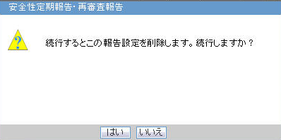

Deleting PSR / ReSD
Click Yes in the prompt shown below to delete the PSR/ReSD report.
