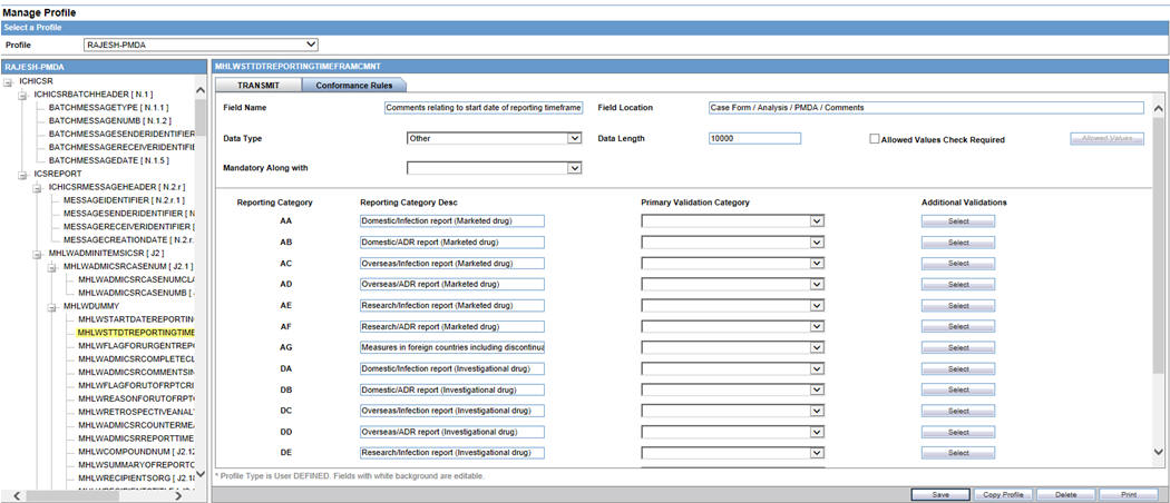

The following is the Conformance tab for PMDA profile:

PMDA-E2B specific fields
| Field | Type | Description |
Reporting Category |
Label |
All Reporting Category (R3) Codes (AA, AB, AC, AD, AE, AF, AG, DA, DB, DC, DD, DE, DF, DG, BC, BD) as configured in the Reporting_category (flex code list) are listed here, along with Nullification. |
Reporting Category Description |
Label |
Description of the corresponding Reporting Category is listed here. |
