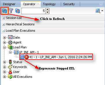

To verify the status of the ETL process, navigating to the Load Plan Executions section and expand the Load Plan folder. The status of the Load Plan appears in Red color with the X symbol, which signifies that the ETL session is not in progress.
Figure 7-2 Stopped Initial ETL Session
