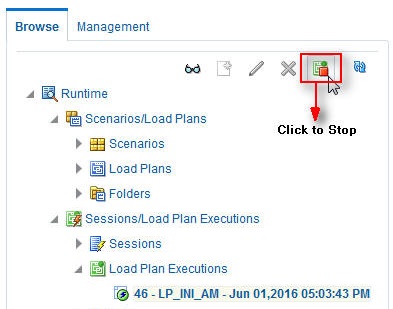

In the Sessions/Load Plan Executions section > Load Plan
Executions folder, select the Load Plan, which you want to stop,
and click Stop.
Figure 7-10 Stopping the Initial
ETL
The Stop Load Plan Execution dialog box
appears.
From the Stop Type drop-down list, select Normal.
From the Physical Agent drop-down list, select OracleDIAgent.
Click Stop.
The Information dialog box appears with confirmation message — Load Plan was Stopped Successfully.
Click OK.

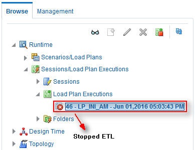

To verify the status of the ETL process, navigate to Sessions/Load Plan
Executions section > Load Plan Executions folder. The
status of the Load Plan appears in red color with the
X symbol, which signifies that the ETL session is
not in progress.
Figure 7-11 Stopped Initial ETL Session
You must verify in Oracle Argus Mart database if the ETL session has been successfully ended after this
step.
