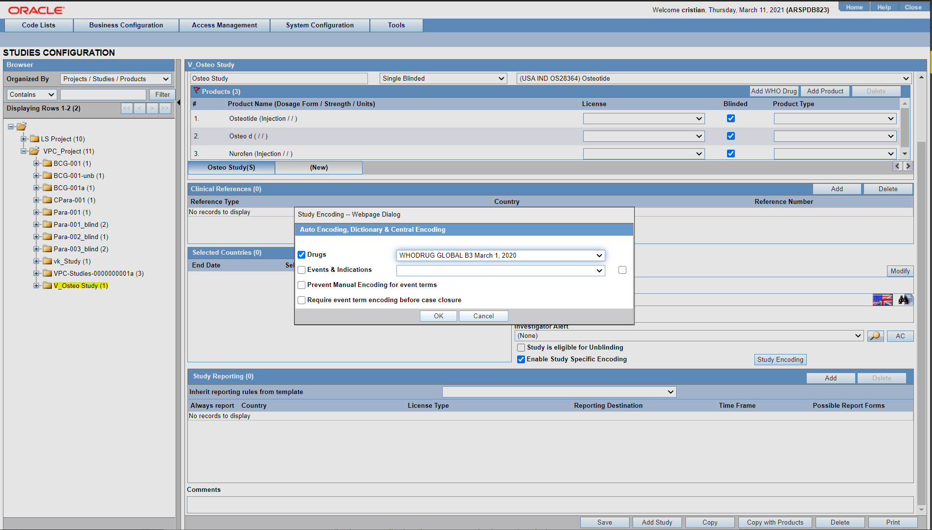

  1. Click Auto Encoding to open the Auto Encoding dialog.
  2. Select the encoding options as required for Drugs and Events & Indications. Use the items in the list to encode. For Study Encoding, go to Console > Business Configuration > Studies > Study Encoding to support Central Encoding for Events & Indications for study cases, in a similar way as for non-study cases. Checking the Central Encoding checkbox (next to the Event & Indications Checkbox) also ensures that Central Encoding also gets reflected (as configured here) in the Oracle Argus Safety Case Form, for study cases.
    Auto Encoding Dictionary and Central Encoding pop-up
  3. Select Prevent manual encoding for Events & Indications, if you want to disable manual encoding by users.
  4. Select the Require event term encoding before case closure, to ensure that the expedited reports display the correct verbatim and coded terms.
