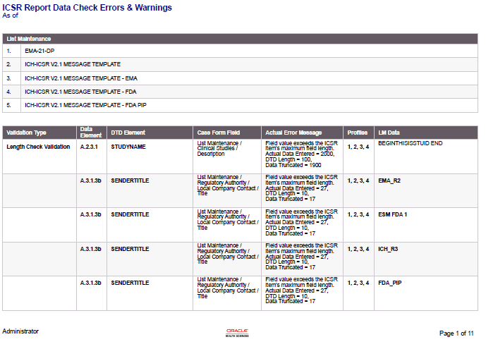

ICSR Length Check Report
The report prints the code list items that exceed E2B(R2) length specifications and also lists code list data that has codes not matching with codes required for the E2B(R2) report.
When Oracle Argus Safety Code List item length is greater than the E2B field length, the data is truncated when maximum length is entered and an E2B report is generated.
This report does not provide the length check and Code check validations pertaining to E2B(R3), eVAERS, and eMDR reports.
Tools >ICSR Length
Check
Tip:
This report compares the lengths of the code list elements with the maximum ICSR length allowed for each of the DTD profiles (ICH, FDA, EMA).It also displays the elements where the length of the code-list element is greater than the allowed ICSR length.
