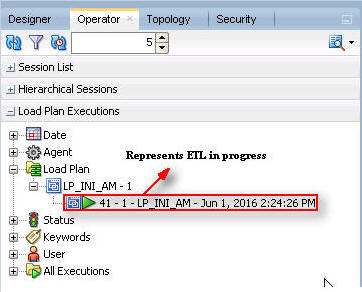

To monitor the progress of the Initial ETL after executing the LP_INI_AM Load Plan, execute the following steps:
Select the Operator tab, in the Load Plan Executions section expand the Load Plan folder.
Expand the LP_INI_AM load plan to view the ETL process in progress.
The status of the Load Plan appears in Green color, which signifies that the process is running properly.
Figure 7-6 Viewing the Status of the ETL Process
Double-click the ETL session, highlighted in the figure above, and select Steps in the right pane.
The list of steps for the Load Plan appears along with the steps that have been completed successfully. The green check mark represents the successful completion of the step.
