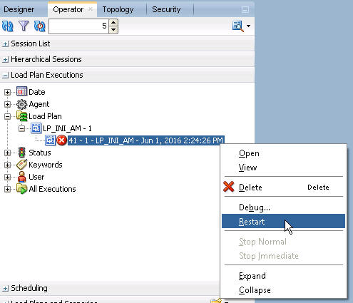

In Load Plan Executions section, Load
Plan folder, right-click the Load Plan,
which you want to restart.
The drop-down menu appears.
Figure 7-3 Restarting the Initial
ETL
Click Restart.
The Restart Load Plan dialog box appears.

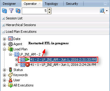

Another Load Plan is added with the same name as that of the stopped ETL, in the
Load Plan folder. However, this instance of the
ETL Process appears in green color, which signifies that the ETL is in
progress.
Figure 7-4 Restarted Load Plan

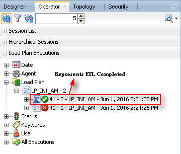

Once the ETL process is complete, the Load Plan is appear in green color with a
check mark.
