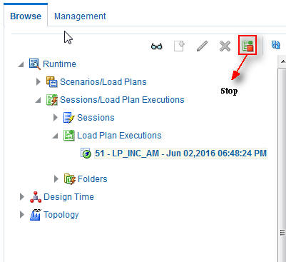

Select the Load Plan, which you want to stop,
by expanding the Load Plan
Executions folder of the Sessions/Load
Plan Executions section and click
Stop.

You can verify the status of the ETL process by navigating to the Load
Plan Executions folder in the
Sessions/Load Plan Executions section. You
can view the status of the Load Plan in
Red color with the X
symbol, which signifies that the ETL session is
not in progress.
