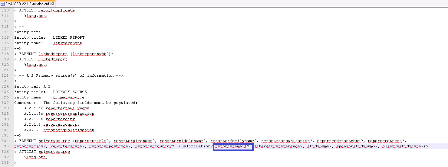

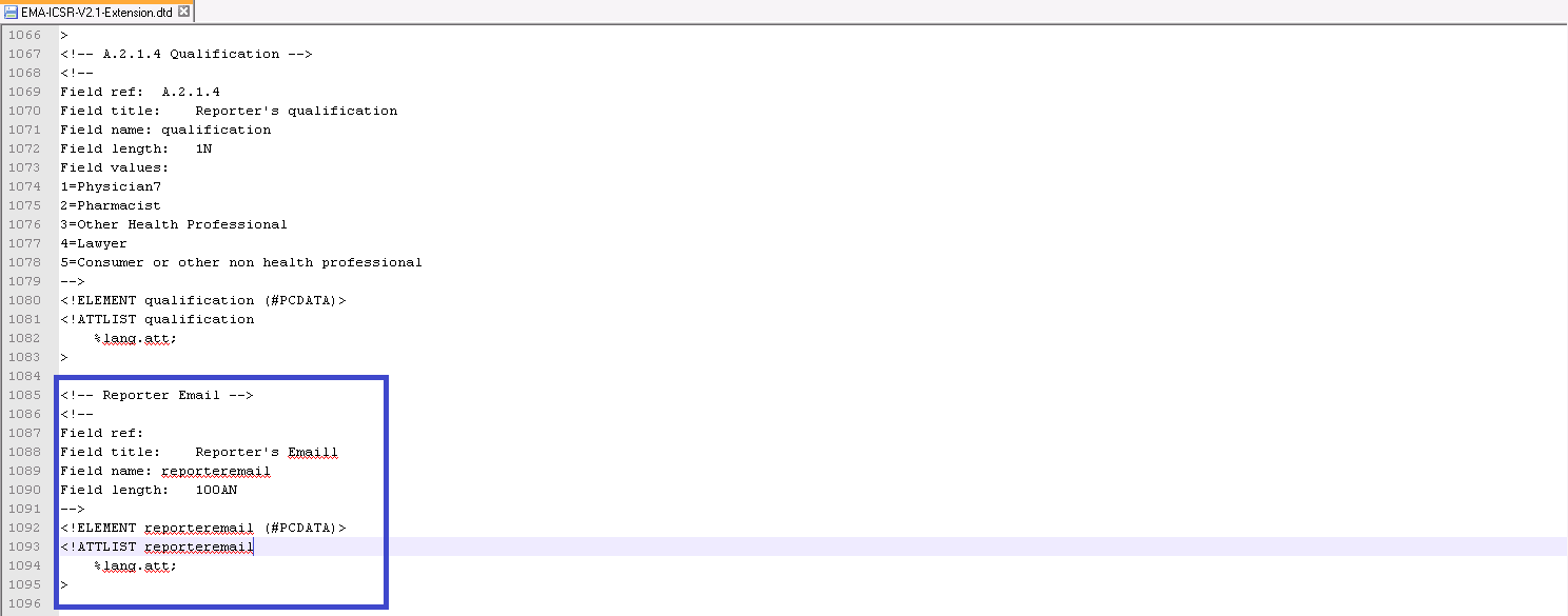

- Add Extension Elements to DTD: This applies only to R2 profiles. Verify that the base DTD is be same as the parent profile from which the profile was copied. Oracle recommends that you change the name of the DTD file.The steps in this section will add the Extension element in the DTD file.
- Take the DTD file corresponding to the base profile chosen in the previous section of this document from the
<Interchange InstallationDirectory>\Argus\InterchangeService\DTDFilesfolder and make a copy of that profile. For example, copy the EMA-ICSR-V2.1.dtd profile and name it EMA-ICSR-V2.1-Extension.dtd. - Open the file EMA-ICSR-V2.1-Extension.dtd and include the extension DTD Element "reporteremail?". To do so, add the element details in the header row, as highlighted in the following image:
- Save the updated DTD file in the same folder where all other DTD files exist on the ESM Server.
- Update the CFG_PROFILE.PROFILE_DTD field of the extended profile with the new DTD file name.
A quantifier (+,*,? or nothing) is a single character that immediately follows the element to which it applies, to restrict the number of successive occurrences of these items at the specified position in the element hierarchy. The quantifier may be either:+ — for one or more occurrences of the item. The effective content of each occurrence may differ.
*— for zero or any number of occurrences allowed. The item is optional and the effective content of each occurrence may differ.
? — for no more than one occurrence. The item is optional.
If there is no quantifier, the specified item must occur exactly one time at the specified position in the content of the element.
