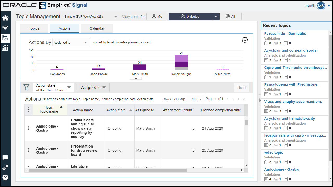

The Actions tab of the Topic Management page provides information about existing actions.
In addition to the Title bar, containing the page title, Topic Workflow Configuration selector, and the View items for selectors, you can use the Graph and Table section of the Actions tab to filter, sort, and view actions.
Graph section
The Graphic section on the Actions tab graphically displays summary information of actions. The Actions By drop-down list contains a list of filterable fields. The type of field determines if a bar chart or donut chart is displayed. You may have to scroll horizontally to see all the bars. A donut chart is a pie chart with a hole in the center that displays the total number of actions. The donut graph displays when you select Action State.

Actions table
The Actions table section on the Actions tab includes standard and custom topic and action fields, as defined by the selected topic workflow configuration, plus Action ID, Action Attachment Count, Created By, Created, Modified By, and Modified.

Filter bar
The Filter bar on the Actions tab appears above the Actions
table and contains a Select Filter button
) for adding custom filters to filter the table below.
Available filters are defined in the topic workflow configuration.
The Action State filter always appears on the
Filter bar but you can change the filter values.

Detail panel
The Detail panel appears on the right. Initially, it displays a list of recently viewed or edited topics and the topic state and the number of actions, attachments, and comments associated with the topic. You can click any topic name to view it.
If you click in any action row, the Detail panel updates to
become the Action Detail panel. It contains four sections: Action
Information, Topic Information, Action Comments, and Action
Attachments. You can collapse and expand each section of the panel.
