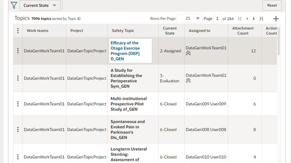

Topics table
The Topics table on the Topics tab includes standard and custom topic fields, as defined by the selected topic workflow configuration, such as Work teams, Project, Topic Name, Current State, Assigned to, Attachment Count, Action Count, Created, and Modified.
Figure 3-3 Topics tab Table section
- The View items for selection and the filters in the Filter bar determine the set of topics shown.
- The Header Action menu (
) provides access to column management and download options, Oracle
Analytics Topic reports, and allows you to add a topic to the table.

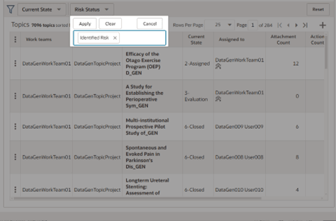

Filter bar
The Filter bar on the Topics tab appears above the Topics table and
contains a Select Filter button (
) for adding custom filters to filter the table below. Available filters are
defined in the topic workflow configuration. The Current
State filter always appears on the Filter bar but you can change the
selected state values.
Figure 3-4 Topics tab table filter
- Click the Select Filter button (
) to add or remove filters. You can add as many filters as you want.
After you add the filter, you select values for the filter by clicking the
filter.
- Click the Reset button to clear the values of the selected filters and set the Current State filter to All Open States. The filters stay on the Filter bar; however, you can redefine the values for each filter.
- To remove filters from the Filter bar, uncheck the filter from the Select Filter menu.

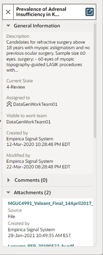

Detail panel
The Detail panel appears on the right. It displays a list of recently viewed or edited topics and the topic state and the number of actions, attachments, and comments associated with the topic. Planned actions are not included. You can click any topic to view it.
If you click a
topic row, the Detail panel updates to become the Topic Detail panel. It contains
four sections: General Information, Comments, Attachments, and Actions. You can
collapse and expand each section of the panel. To view the topic, click the
View topic icon (
Figure 3-5 Topics Management Detail panel
