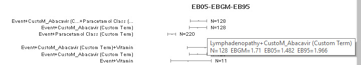

Information about an event and drug interactions is represented as a nested confidence interval graph of EB05-EB95 confidence intervals and EBGM values for two drugs and the event.

    For each combination of two drugs and the event, the graph displays a series of confidence intervals, with the highest dimension shown first. The first confidence interval is for Event+Drug+Drug. The other two confidence intervals are for Event+Drug. You can compare the strength of the interaction between the two drugs and the event with the strength of the interaction between the individual drugs and the event.
    In each confidence interval bar, the EB05 value is at the left end, the EBGM value is the dot on the bar, and the EB95 value is at the right end. The count (N) of cases with the combination is also shown at the end of each bar. Bars are colored according to the color key below the graph. To indicate a possible interaction, the confidence interval for the Event+Drug+Drug combination displays in red when the INTSS (Interaction Signal Score) value is greater than a predefined threshold that is set when signal management is configured. For more information about INTSS, see MGPS computations and Logistic regression computations.

  5. If you point to a confidence interval, the names of the event and the two drugs appear. The following information for the Event+Drug+Drug combination also appears in the sample confidence graph:Sample confidence graph.
    • N—Observed number of cases with this Event+Drug+Drug combination.
    • EBGM—Empirical Bayesian Geometric Mean. A more stable estimate than RR; the so-called shrinkage estimate. For more information, see MGPS computations.
    • EB05—A value such that there is approximately a 5% probability that the true Relative Ratio lies below it.
    • EB95—A value such that there is approximately a 5% probability that the true Relative Ratio lies above it.
    • INTSS—Interaction Signal Score. A way of measuring of the strength of a higher-order association above and beyond what would be expected from any of the component pairs of items of different types.
    • EXCESS2—A conservative estimate of how many extra cases were observed over what was expected assuming that only a single cross-item interaction is present.
